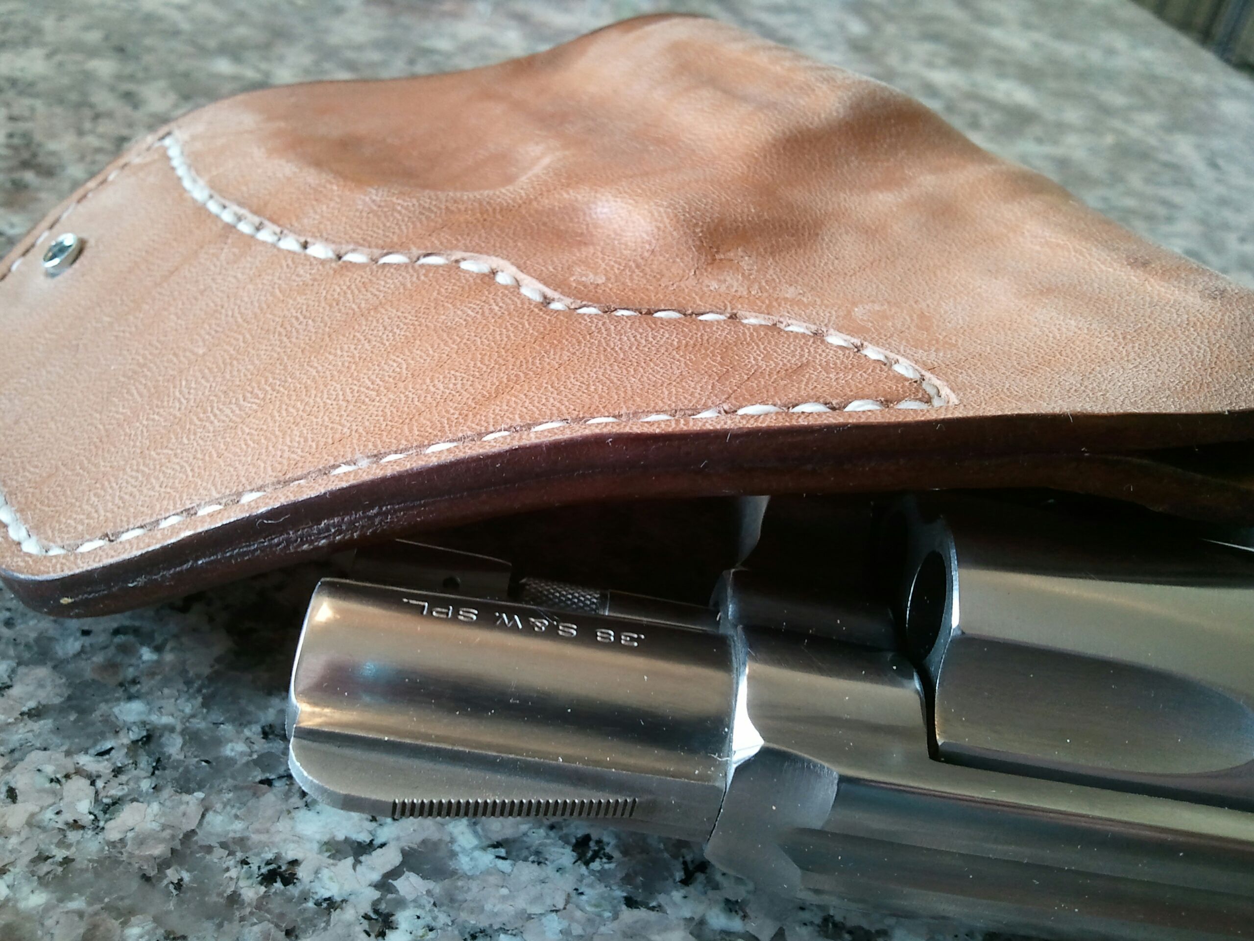

  2. Scott, Sorry about the bad picture. I just beveled the outside slightly on my belt grinder. I glued the two slightly oversize and sanded smooth then grooved and stitched. I should probably work the edge a bit more, starting by sanding to a finer grit. Really wanted to see if the beeswax and hard felt buff would do the trick or not. I'll work it more. Hopefully this is a better picture Jeremy

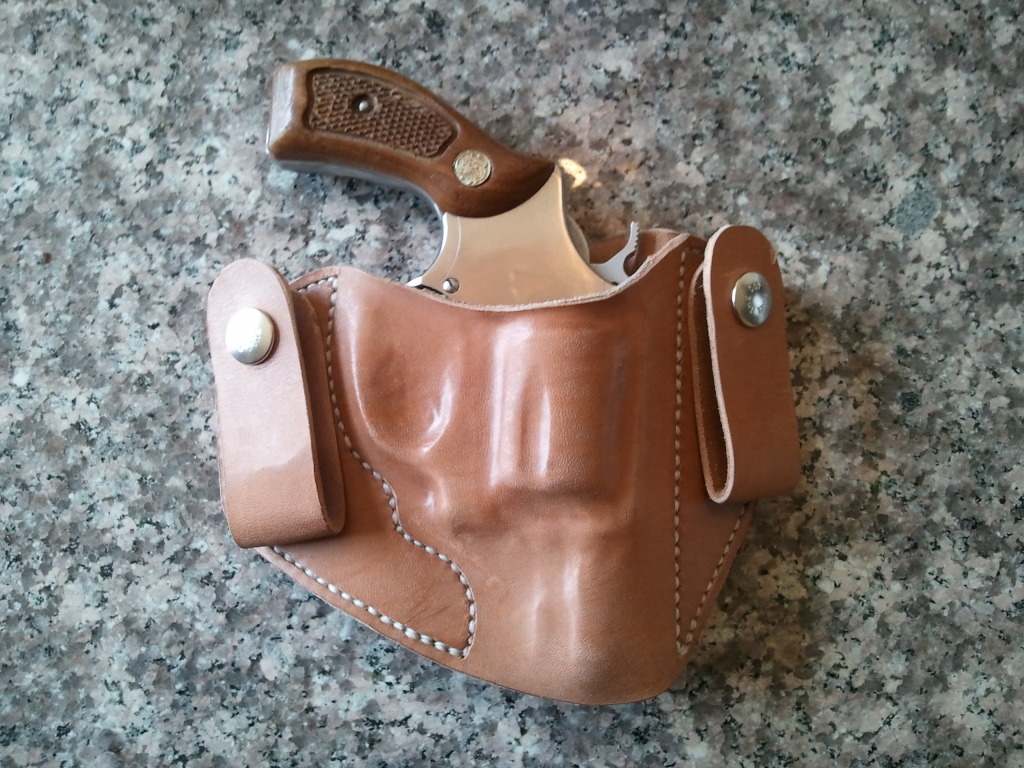

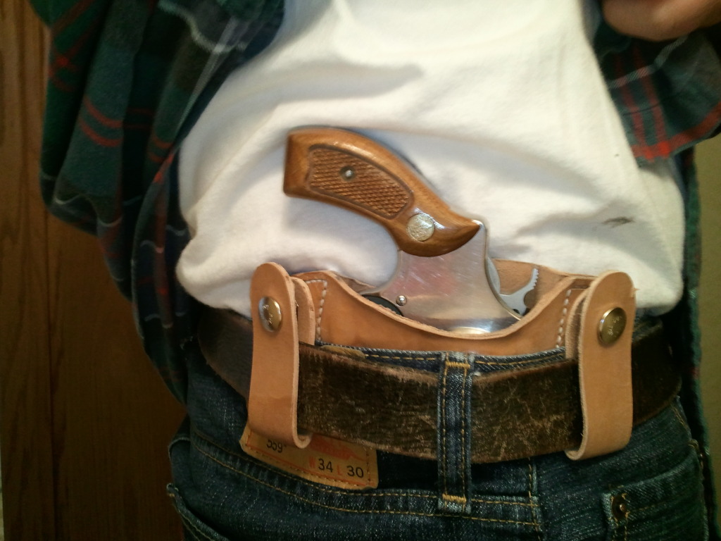

  7. Hello, first post and my first holster. I'm looking for some feedback and pointers. It is not complete, my stainless T nuts haven't come in yet. (8-32 if anyone was wondering, same as on a Bianchi I have) It will be IWB S&W Model 60 J frame Horeshide from Springfield Nyltex thread, the white discolored and came back to white after a stint in the oven at 125 or so for 40 min. Is this a good thread (saddle stich by hand) or should I look for something else? I may change to black thread, I plan on doing many more holsters. What is recomended as a sealer or can it be left natural? I'm guessing seal it. I have Scotch Gaurd, Fieblings Neetsfoot oil, Mink Oil and Saddle soap on hand, may even have Sno Seal. I think the oils are out because they will soften the holster. I may use the saddle soap to burnish the edge. Is a Head Knife worth buying or what do others use? What brand of Head Knife should I look for? I appreciate all pointers and critism Jeremy
