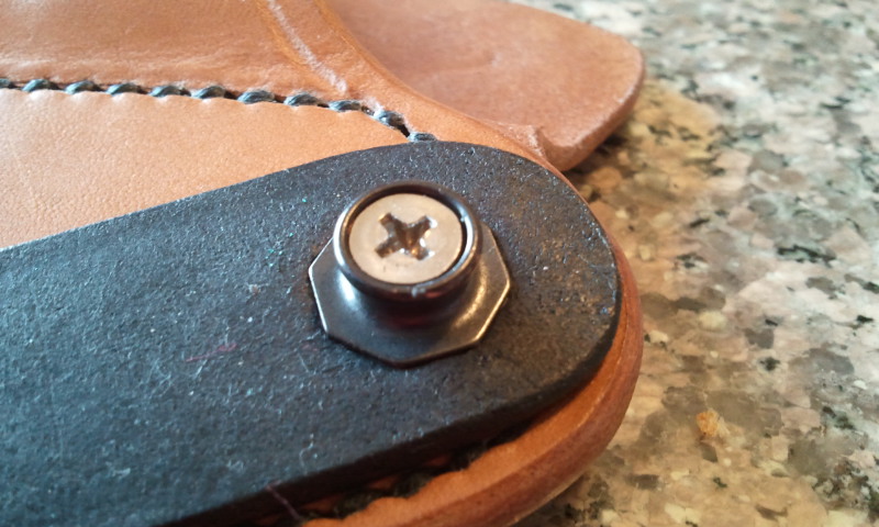

"screw" Line 24 Type Snaps
J Hayes replied to Russ's topic in Gun Holsters, Rifle Slings and Knife Sheathes
I sandwich the T nuts between the layers. 8-32 x ¼ Tnut and 8-32x3/8 flat undercut machine screw both stainless steel. I clip a bit of the prongs off on the T nut and when I glue everything together I have plywood drilled for the t nut barrel and the clamp the heck outta them. The prongs of the t nut protrude every so slightly and tend to bite into the belt loop a bit which helps prevent them from turning I feel. The key to using the 8-32 is the undercut head, it sits a bit lower in the snap allowing plenty of room to not impede function of the snap. I personally feel 6-32 is a bit light for my comfort level. Jeremy -

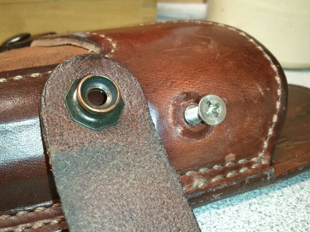

This is a Bianchi holster, I'll get you more later today. These are 8/32 screws and are stainless steel. Lift the spot YKK snaps. Don't skimp on your product. Jeremy -
Stainless steel t nuts from Steel marine fastener and undercut head stainless screws from McMaster-Carr. I make the hole in my loops big enough to go over the post of the T nut. I'll get some more pictures later today for you. Jeremy -
