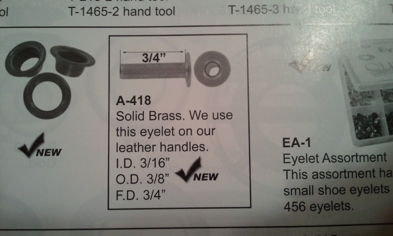

  16. Ohiotravelbag.com catalog P212 page 21. 800-800-1941 they have more too. These are solid brass which is nice I think. Jeremy
