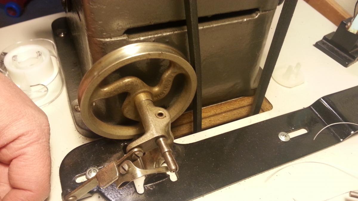

  21. I think its a table mounted winder. The wheel gets tipped or pushed forward making contact with the drive belt causing it to turn. It needs to be screwed to the table close enough to the belt to make contact when pushed forward and be clear of the belt when disengaged. As the bobbin fills a tab on the winder contacts the tread automatically disengaging it. I'll get you a few pictures of one I have. Jeremy
