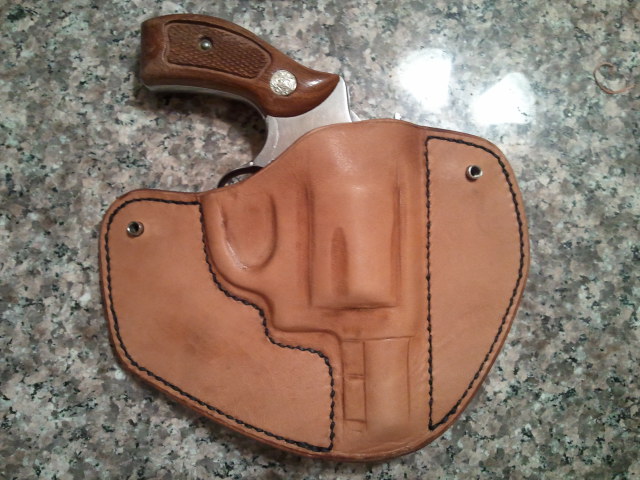

My personal carry rig is almost identical to the posted one, it holds pretty good but I do wish it was a bit tighter. I guess I'm chasing perfection, I'll never catch it but I can make it look better than it does. I want to mimic the lines closely, and I like to bone the detail in, even though nobody sees it. The ones I've done for a G23 and 1911 Commander were much easier to get the lines tight, all IWB. Jeremy -

Yes it is an IWB, hopefully it won't be too tight, but I'll have to stitch it to find out. Kinda wish I had a machine just to do patterns, I'm not real fast at hand stitching. Revolvers are a PIA Jeremy -

Just trying to perfect a pattern and was wondering if this looks ok or if I should move the stitch line closer. Any thoughts or critizism are welcome. S&W J frame, horsehide and Barbour's 7 cord. Thanks Jeremy

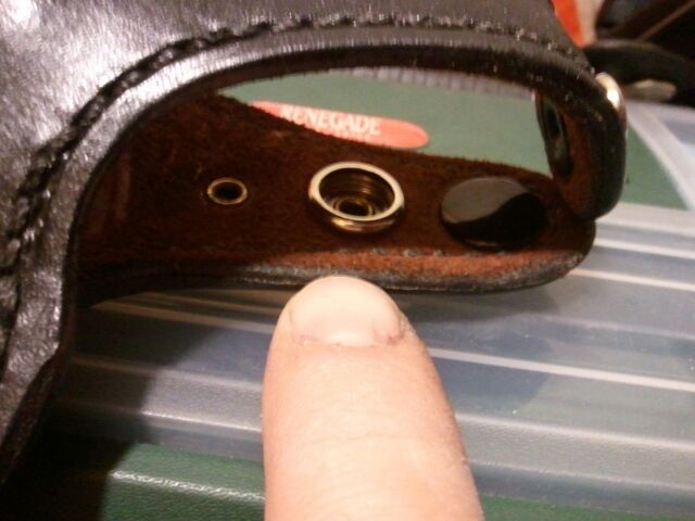

Should've posted this picture first.I was thinking of kydex formed like a bridge or stitching another layer on the strap. Holster will be made from 9/10 HO Glockanator, thanks for the link on the plastic part, I need that too. Jeremy -
Is there any acceptable way to put a bumper around the snap socket on a thumb break to help prevent the socket from dragging on the gun when holstering and unholstering it? Or should I just not worry about it? It will be on a cyclone type for a 6" Smith 686. Thanks Jeremy
