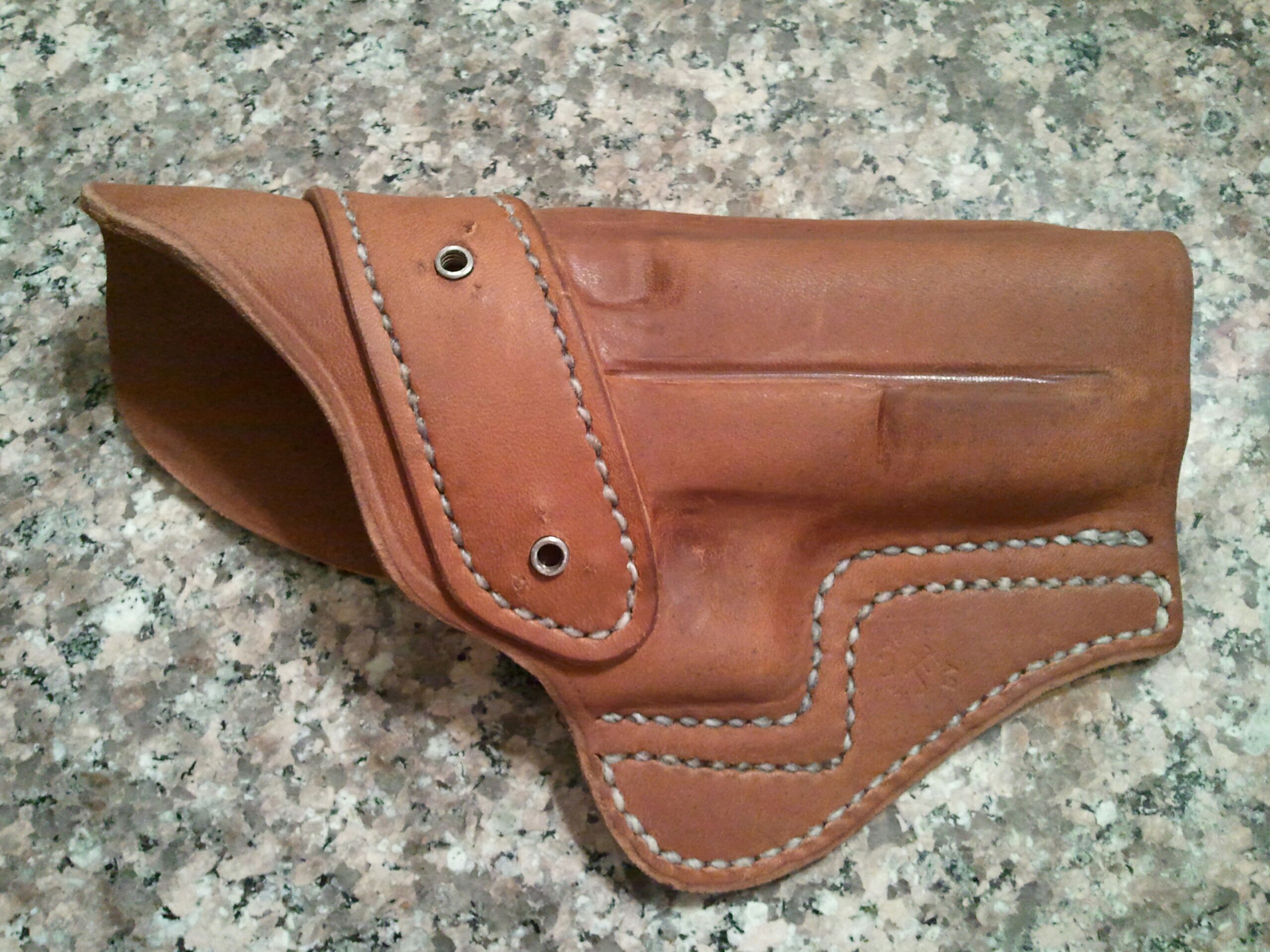

I just finished another horeshide IWB but it didn't dry real stiff like the last one. Had it in the water for 1 minute at 120 degrees with a drop of dishsoap. It wasn't quite as tight as the fisrt one. Any ideas? The first one I put in the oven for an hour at 125°. Could that be the difference? This one I put in my dehydrator at 125 for an hour as well. Thanks for the help Jeremy

All this hand stitching looks amazing! What thread is everyone using? Waxed or unwaxed? I've been using white waxed nyltex and it comes out looking dirty, any tricks to clean it up? Jeremy 012-03-19_11.26.50.jpg]

Sandwich the t nut between the layers, the the belt loop can easily be replaced on IWB holsters. I use 8/32 stainless t nut and screw, the screw head must be turned down a bit to allow clearance for the snap. Picture is of a Bianchi 120, that's how I determined what size t nut and screw to use. The strap I am unsure of the length, I just made a paper pattern from the Bianchi one. I will measure it layer for you. Lift the spot snaps, or Pull the dot snaps. Jeremy -

I just ordered stainless t nuts from steelmarinefasteners.com $36.30 box of 100. The stainless is more money but I think it is worth it, I hate corrosion. They are 8/32 x 1/4 sku NTEENUT8-32, shipped fast. You may have to shorten them for thinner leather but on 9-10 oz they protrude just slightly. I also ordered the screws from them, $4.44 box of 100. I got the size and material off a Bianchi holster, they use stainless. I did find i needed to make the head smaller to fit the snap socket well. Easy to do, put the screw in a drill and run it against my belt grinder. I like stainless. Jeremy -
