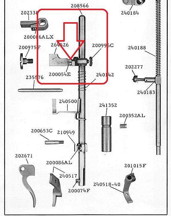

  5. looks like screw # 200054E is loose or missing
