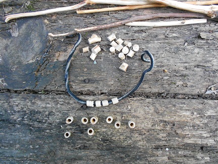

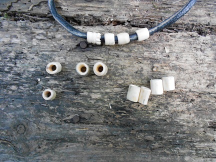

This is some simple wooden beads i made from small tree branches and put on some leather lace for a simple bracelet. Still have to make some type of clasp to hold it together but for now this is what i have done so far. Learning how to do it was fun and will make it easier to make more in the future and help me create many different designs and so on. Hope you fellow leather workers like it .
This is the look of the wooden beads i made from tree limbs that are in picture. All so what the beads look like after cut from tree limbs into wood pellets before drilled out in filed and sanded. This was a fun project have some more work to do on them but this is the general idea of what it will look like.
Thanks for the suggestions and yeah being that the length of the lace vary from 12 inches to smaller pieces you can only do so much . I am going to make some primitive bracelets with some wooden beads. I did some research and found out i can make very simple wooden beads from tree limbs . Also you can use fruit tree branches as a fragrant wooden bead that when rubbed will give a fragrance of the fruit. i have some pear and peach trees in the yard i will use those for the fragrance beads and some cedar and pine trees for the others or what ever else i find that has a good color in the wood . Only bad thing from my research is that the wood has to be seasoned or dried or the wood will crack if you make the bead before allowing it to dry. So this week i will be gathering wood and trying different things will add some pictures of the progress once i do.

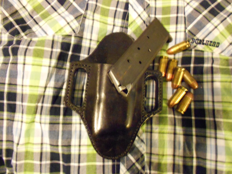

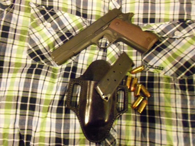

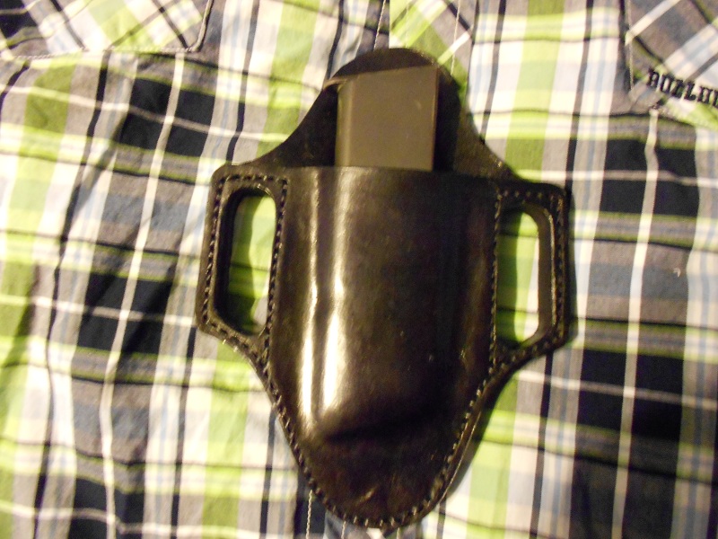

Here are some of my first leather mag pouches for a 1911 handgun. Took me awhile to make them was a fun learning experience. They fit all standard 1911 7 or 8 round magazines like for example the colt, Springfield , kimber, Thompson , etc. The belt loop holes will fit any size belt and can be worn on either side left or right. These where wet molded to the mag to get a good fit and tension to hold the mag in place. I also left a lip of leather above mag to help with comfort when twisting and sitting. Leather was dyed charcoal black and sealed with leather sheen to give it a gloss finish and waterproof the leather against sweat. Anyone interested in this product can go to this link http://gun-leather.ecrater.com/p/15332119/1911-mag-holder

I just finished dying the leather black still need a lot of work before finished . I'm gonna use some fiebings leather sheen as a top coat any thoughts on how to apply it to get a good finish too it i have heard you need to lay it on thick. I will update the progress with some more photo's

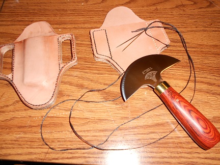

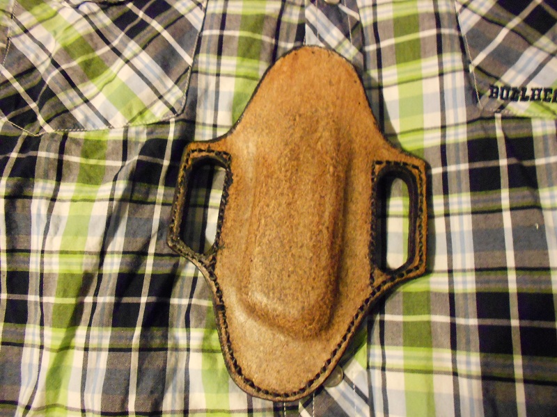

I just wanted to add my design of a pancake style mag holder with belt loops punched out on leather . To give a better idea of what the stitch lines look like and how far apart they are to get a good wet mold without affecting the stitch line and what length is needed to be able to have enough room for the mag to fit in the leather. These two mag holders in picture are my first attempts after making templates from wood to make four of them . this is the ruff in before final touch ups of edges and cleaning before dying . -
OK i think i figured it out. here are the pictures that did not upload of my mag holders for a 1911 handgun.
Hello i am from Gray GA , and thats not to far from warner robins its a drive though lol fairly new to leather and this site. This is my latest project some 1911 mag holders ruffed in before finishing touches and leather dye.

I'm new to leather making also i have just finished the ruff in of my mag holders before i dye them . I used hobby knives with replaceable blades to do all my cutting. This method do able but takes a long time and i rather look for other methods like using a round knife. I just ordered a stohlman round knife. yes i am aware of the quality of the blade but its in my budget and im gonna give it a try. I will take it to my buddy who is a blacksmith making knives if it gives me any trouble with the blade he will will make it work right.
