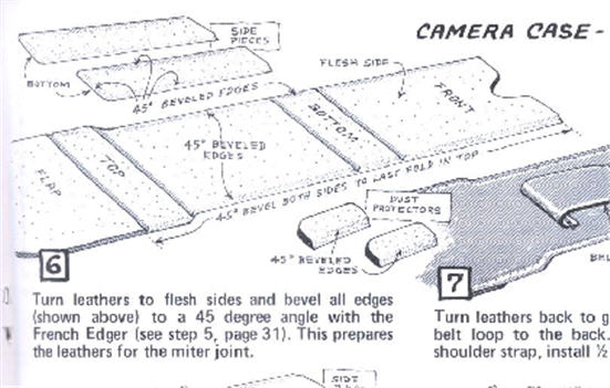

Sure, I am making a small box, picture the end and the side meeting. You could have 2 joints a butt joint or a miter joint. I have seen in books that the miter joint is easier to sew but I don't know. Looking for advice. Please see a few pictures to help clear this up. See the 45 in the picture to the right... Thats what I am talking about. The butt joint you usually place against a block of wood to hold it steady. What do most use? Is the 45 necessary? -

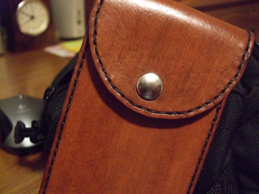

Because I have not done much fabrication yet I would like to talk about the order of getting things done on a project. I have posted a question on dying before gluing the liner but I want to start at the top and capture everything if I could. This is a cell phone case, Very basic and I hope this thread helps other beginners. • First I cut the leather and the liner • Slightly bevel all edges (grain side) of the leather to give it a finished edge. • Groove all pieces that will be sewed (depression for thread) • If tooling wet leather and tool design • If you need a miter joint cut 45 degree joints for sewing • Dye all pieces of leather • Glue liner to pieces of leather • Trim liner to fit • Sew around each piece to attach liner and leather • Sew project together • Add snaps either before assembly or after depending on the room you need to get the snap on. • I think think that’s it Let me know if you agree with these steps Thanks Steve
