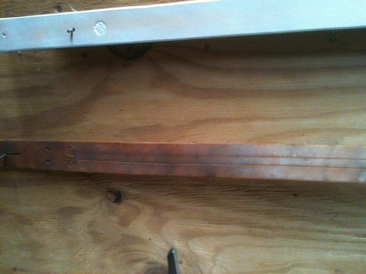

  6. THank you! I just checked it recently and it seems to have evened out a lot as it has dried more. I'm kind of shocked that it was that obvious and easy :-P

  9. The only thing I did to it before I dyed it was sand the edges and buff the surface with water :-) So there is no soup or oil on it, at least not from me. Could it have just been too dirty? Do I need to clean with saddle soap before I dye it? Oh and one more question....if I use an airbrush, will that control the unevenness entirely? Because this is dip dyed so I'm under the impression that the problem is with the leather it'self. But I've never tried airbrushing so I don't know.
  10. Hi everyone! My dyeing skills are kind of hit or miss, so on this belt I thought SURELY if I dip dye it, it will be even enough right? Does anybody know why it looks like this? This picture is taken a few hours later, so it's not totally dry yet, but I would be shocked if all of a sudden it was even once it's dry. Shocked but happy! Also, it seems to have like a greenish shimmeryness to it, in blotches. Not sure what that is either. Oh and I dip dyed it in Fiebings Oil Dye, saddle tan :-D Thank ya'll for your help!
