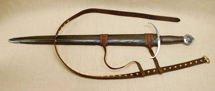

Seems like a lot of work. Why not just do a hidden edge-flesh stitch on a butted seam, like the Vikings used to use. Here's my latest scabbard -

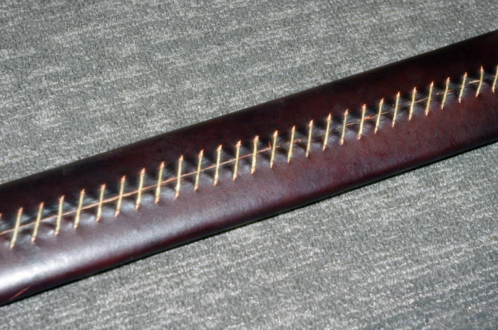

Stitches used on Medieval scabbards: 1. Butted seam with a running whip stitch (show in the original post) 2. Butted seam with a hidden edge-flesh stitch 3. Closed seam with a saddler's stitch Stitch spacing seemed to be around 3/16" to 1/4" -

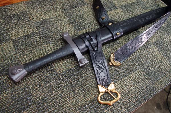

Here are examples. One photo of another one of my scabbards, the other is an image from Medieval illuminated manuscripts showing the same thong belts. Manuscript: Massacre of the Innocents, Germany, c. AD 1350, British Library, London, Shelfmark Add. 17687 B The offset belt pulls the scabbard into an oblique angle so it does not hang vertically, also places the sword's grip forward so that it's easier to find and grasp. The tighter the belt, the more the scabbard is pulled obliquely. -

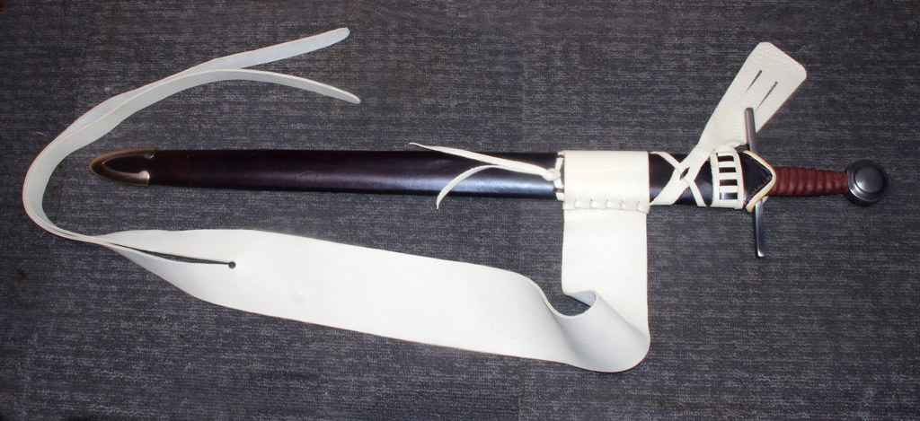

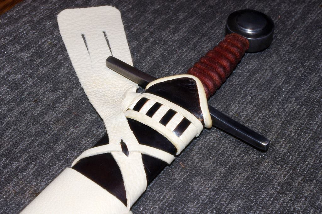

Medieval sword scabbard This is a historically-accurate reproduction of a scabbard that is depicted on a statue at the Naumburg cathedral, German Empire, circa AD 1200. 1. Carved 2-piece poplar wood core lined with a fullered, woven-wool textile 2. Veg-tan leather cover (2-3 oz) dyed with Fiebing's Medium Brown 3. Oil-tan Latigo leather belt (6-8 oz, sanded down to 3-4 oz.) in a factory drum-dyed cream color 4. Natural linen thread 5. Bronze chape 6. Hide glue Sword is a reproduction of an Oakeshott Type XI sword (made by Del Tin, model 2121)
