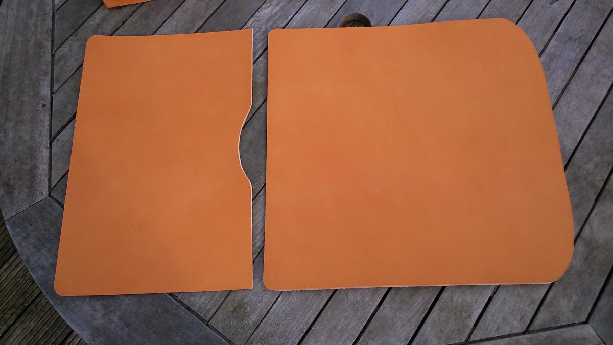

Here is todays progress I cut out the pieces using the templates I made this morning. I marked out the gusset piece and used a groving tool to score the inside of the leather which I then wet to make it easier to bend. More detail on my blog Michael
Thanks Monica I am happy to share the progress. This morning I have marked out and cut the front flap the document case I used for my inspiration has gone to a new home and although I have others in my restoration queue they are all slightly different. I wanted to check the symmetry of the curves so I made a single corner piece which was a really good idea as they did not match.

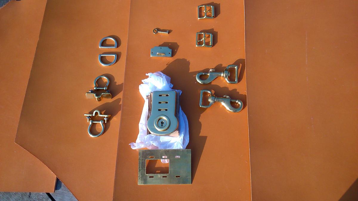

I am making a new case for myself the design comes from some old English cases that I have restored. Although the handle design is a combination of an old Gladstone bag I am working on and a video I saw on youtube. I am using a London Tan English bridle hide from Sedgewick's. Hopefully I have uploaded three pictures one shows my components all the brassware is made by Abbey England and was very reasonably priced. The other two show the handle which is the first piece I have made there is a full story on my blog if anyone is interested. As the interior will be green suede I have decided to use green thread I am not 100% sure of this (thread colour) but I am going with for now. Thanks MIchael
