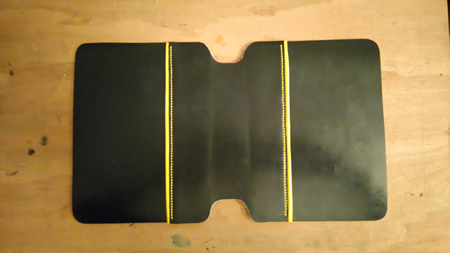

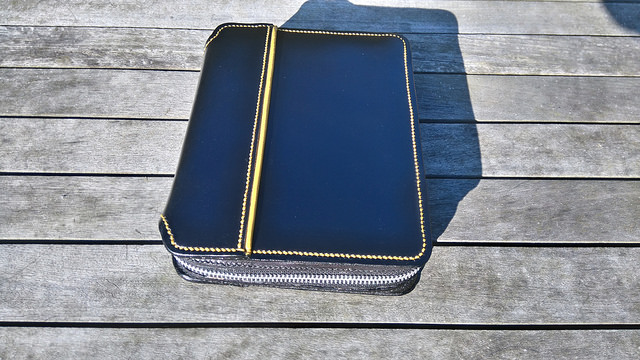

Thanks for the prompt response. I realised my mistake when the cover did not fit the closed case so I made the spine piece overlap as you can see in the picture. Your reply was very helpful
My most recent project involves a case made in two parts an inside and an outer cover. Both parts are ready to be attached together my problem is I cut the first cover with the case open and when I closed the case the outer was too short. so I have made another outer cover. My question is if I glue and sew the inner piece what happens to the extra material when the case is opened I hope this makes sense

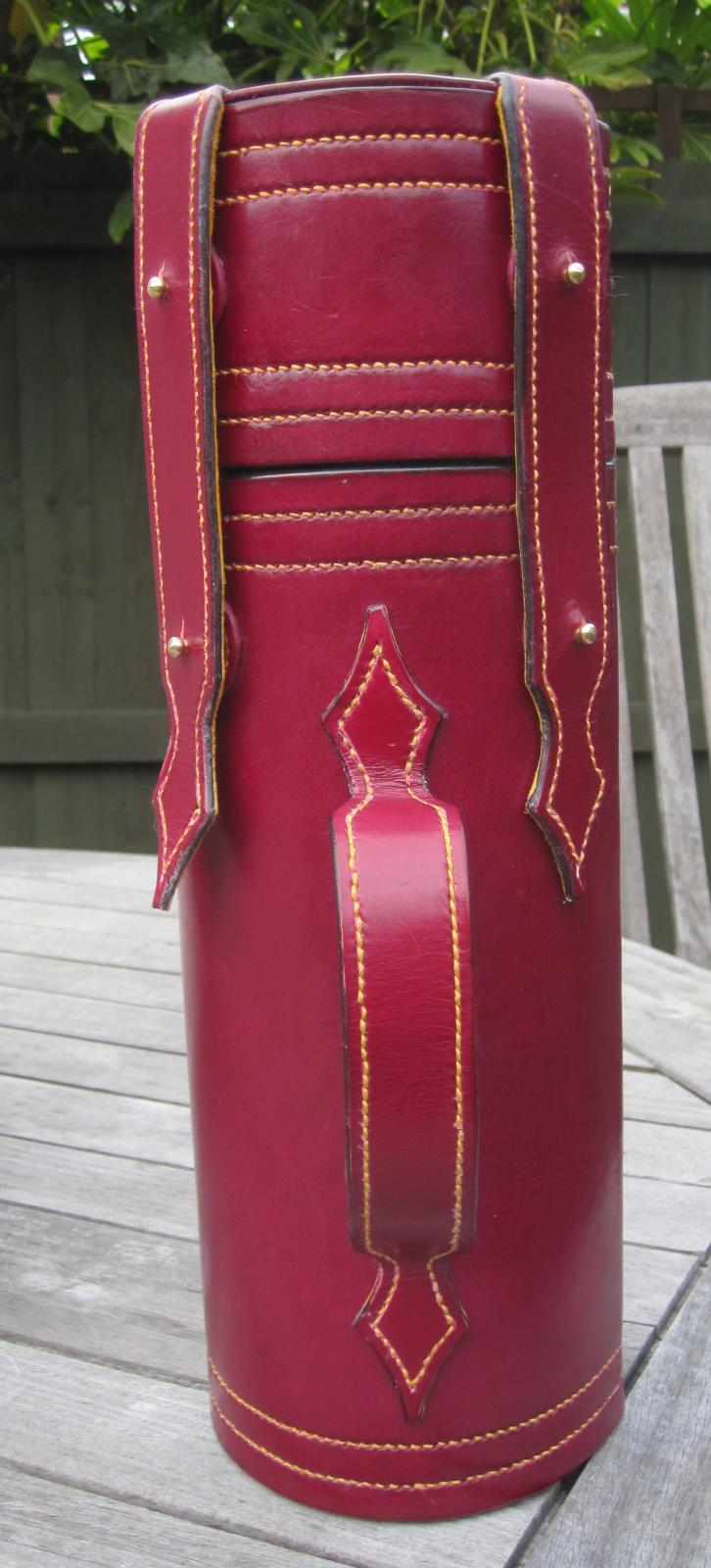

Thanks Monica I have a box full of things that I did not get right my stitching is an issue but in my defence I do have some pretty serious issues with my right hand which requires more surgery very soon. The Gladstone bag is for myself and unfortunately it keeps getting put on one side while I do other projects which I am being paid to do so that is ok. I have fitted the handle assembly but it needs adjusting as it does not sit well. Being totally honest I don't have a use for it but I really like it. It is like my collection of writing slopes I don't use them but I like having them I have added a picture of my latest project for a fellow fountain pen addict it is a cover for a Hobonichi planner she asked if I could carve a bird on the front, she owns the big red cylinder case I made a couple of years ago I had better check to see if that is on my blog. I have attached a picture so everyone can see it. I enjoy carving I would love to know how you vary the depth of you detail especially on the foxes which are neat btw. Michael -
