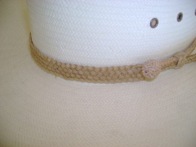

For the Flat rawhide, I just increased the number of strings to eight in an O,U,O,U on the right and U,O,U,O,U on the left. I started the 8 plait round and braided down until I got the length I wanted the then just started the flat braid sequence. Nothing fancy or mysterious just need to practice getting the tension correct. I did the opposite after getting my length for the flat. Doing it this way leaves on side higher than the other by one strand. If someone knows of a different way of doing it I am all ears. Keep Braiding, Heather
Ok, having way to much fun with hatbands. So much so that I am not getting my other work done.... Thanks for the nice words, you guys make me feel all warm and fuzzy:) So this is "The One", my favorite design, its adjustable and in rawhide. I used all 3/32 string and swore a whole bunch while beveling both sides but I think it was worth it. I still need some work in my transitions but nothing a bit more practice wont fix. Keep Braiding, Heather

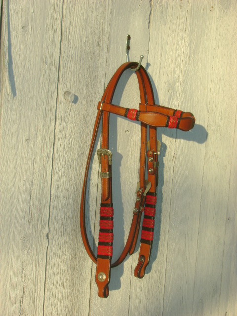

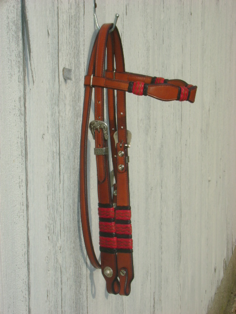

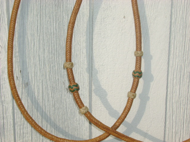

No offense taken Mike - She wanted something with a little "grab" to it so it wouldn't slip in her hands. When I asked about the knots for the slobbers she said make it match. The Customer is always right...lol Speaking of the customer always being right, I sent the pics to the lady and TX and there wasn't enough red so I added more. Skip - I use leather belting as a core unless I am trying to get a really soft feel then I will use a high test climbers rope. Megabit - there is a reason I didnt photograph the front of the slobber straps ...lol... They need lots and lots of work. I think I will be buying them from now on.... Thanks Horsehair, I really like the concept but as I said my slobber straps need lots of work. Keep Braiding, Heather
Had some fun orders come in and thought that I would share. 10 ft long trail reins in 12 plait kangaroo with rawhide knots and slobber straps - She wanted a little color so I added some green to the grab knots and the knot marking center. Headstall for a lady in TX - I really enjoy the red and cant wait for her to send me pictures of it on her horse. Keep Braiding, Heather
