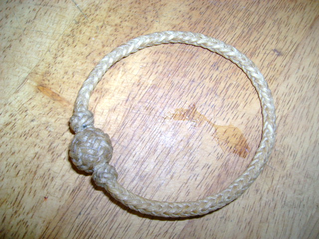

Had a little time away from the kids so I figured I should play with some rawhide again. It has been awhile so I decided on making a bangle bracelet. It measures 3 inchs across the center and feels big to me but I am not a wearer of bracelets. (How does that saying go, measure twice????) Does any one know what the usual size is for one of these?
