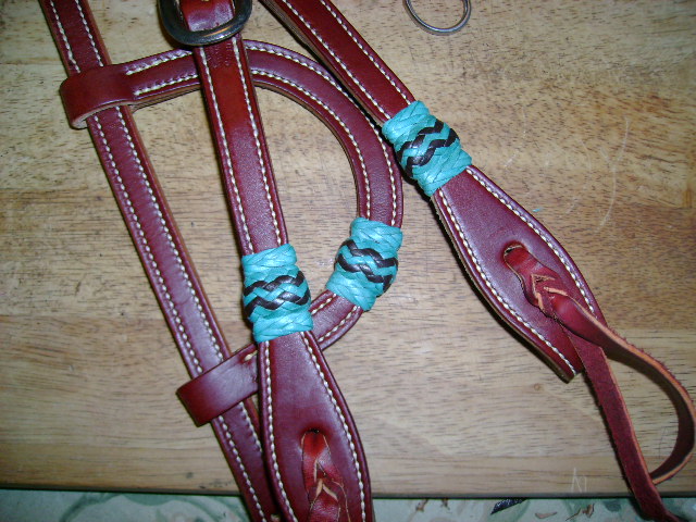

With spring around the corner and full time riding on its way, I decided to make a new headstall for the lead mare and make it little easier for the lesson kids to find it. Long pineapple with 2 accent colors

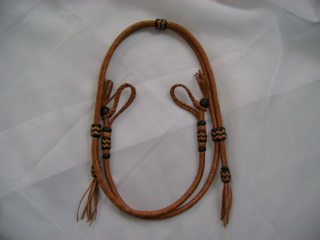

What is the main purpose for the reins??? For me (just one opinion in a million of riders) I want my weight placed where the drape of the reins will be. This is determined by the level of training and discipline of the horse and rider and the length of the horse's neck. Example - Western pleasure horses have a lot of drape and most of the weight is placed directly under the crest of the horses neck. (even adding wieghted ferrules in that section). Reining and Working cow horses have minimal drape on their romals and the weight is usally closer to the bit. Someone using them for trail riding might only need what you have done already. Every horse and rider combination are going to need/want/use something different. When you take the romal into consideration we add another variable; how much weight does the rider feel comfortable with. The weight on the romal helps the rider control the drape and feel to the horse while riding one handed. For me, I change the weight mostly with my Poppers (stingers/wackers/Tails). Reins chains come in different lengths to help change the feel/weight of the braided reins. I dont use them so how the different lengths effect things I cant say. When placing buttons on the reins we also have to take into consideration the life of the reins - This is more important when working with rawhide but also affects leathers. Buttons that are place tightly together will keep reins from bending. Most knots are placed around an inch apart to give more freedom of movement to reins. So the use for the reins also affects how tighlty we can place our knots. Just something to keep in mind and again is a personal preference. What it comes down to is personal preference and knowledge of the rider. Most folks dont know and will ride in what ever they bought off of the shelf or you make for them. Your reins are beautiful and once you determine your purpose and horse for them the knot placement will work itself out. Heather

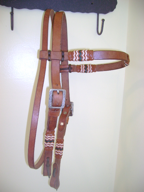

I like!!!! Have you tried it on a horse yet??? I know the first couple that I made where shall we say "off" in size. I had to tweak the pattern to fit the horse a little closer so it wouldn't bump them in the chin. Seeing your tiny strings reminds me that I need to find an excuse to braid with rawhide soon... Keep up the great work. Heather

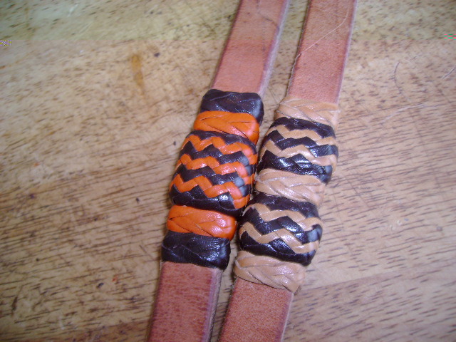

Finally got some time to post some of the items I have been working on. Knots on reins and headstalls for some folks. I also did a pair of hobbles for a couple that wanted a set to hang on a mantle. At least I am busy..... Let me know what you all think.... Heather

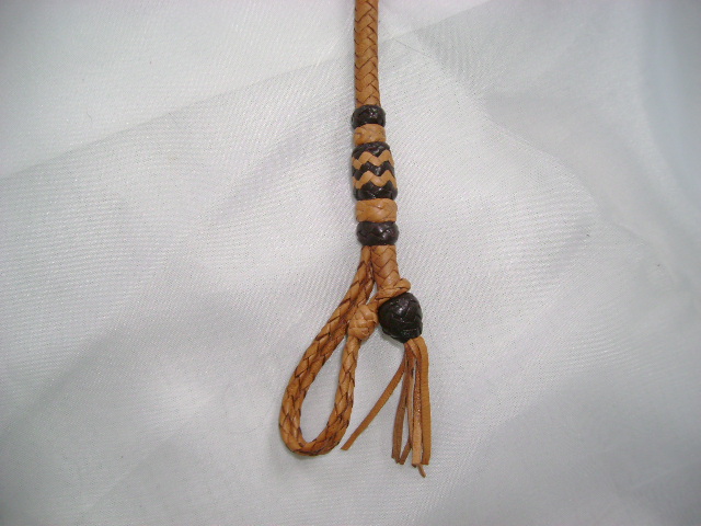

khoiphan92 This is a 8 plait braid over a 1/4 inch climbers rope core . The pattern is made by keeping the same colored strings on the same side. (4 green on left, 4 yellow on right) Braid in a under 2 over 2. I measure the total length needed including the hand and snap loops and leave about 4 inches of tail for the back braiding. After braiding the finished length, I make sure my ends are secure, condition it and roll it to smooth out the braid. I then position the loops so that the colors match back up and follow the pattern back through and finish it under 3 before I cut the ends, rolling them a second time to even and smooth everything out. I placed a spanish ring knot for a base and then covered it with a pineapple knot. I used just under 92 ft of beveled string for this 6 ft leash which includes the accent knots. (better to be long than short) Hope that helps and I am glad you liked the leash, Heather

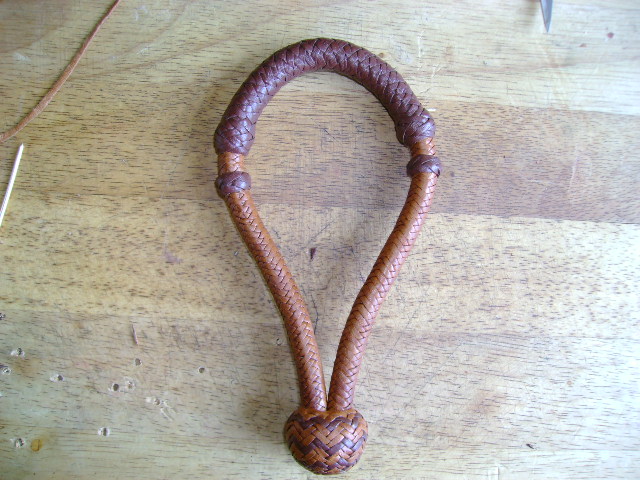

I have been seeing alot of nice Bosals being posted lately so I thought that I would make a hanger to go with them. 3 adjustment knots lets it fit a multitude of horse heads.
