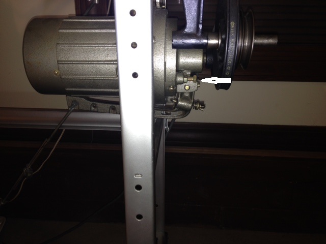

This clutch motor came with the Claes 8345-30 Patcher that I've been restoring. The machine seems to be sewing well, and the motor and clutch are working, at least I haven't noticed anything obvious other than the often discussed issue of the machine starting abruptly versus the servo motors. My question is, what does the large bolt and locking nut in the picture do, and what is the theory behind it's adjustment? In other words, I'd like to know how to tell when it's adjusted correctly? Thanks in advance.
