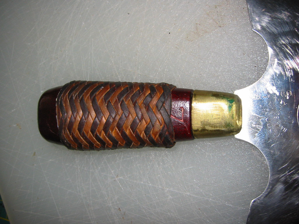

I was rummaging through an antique shop and I ran across this W.Rose head knife in with some kitchen utensil. I payed the seven dollars they were asking(I figured the price was fair) and skipped out of the store. It needed some work so I took to sharpening it and threw some roo around the handle. The edge it carries is scary sharp. I'm not sure what the knife is really worth but I'm sure I can get my money back. You never know what you might find and where you will find it.

I have a couple of old W. Rose round knives. It's scary how sharp you can get them but I haven't heard anybody talk about them. Are there many of those knives out there and what do you think of them?

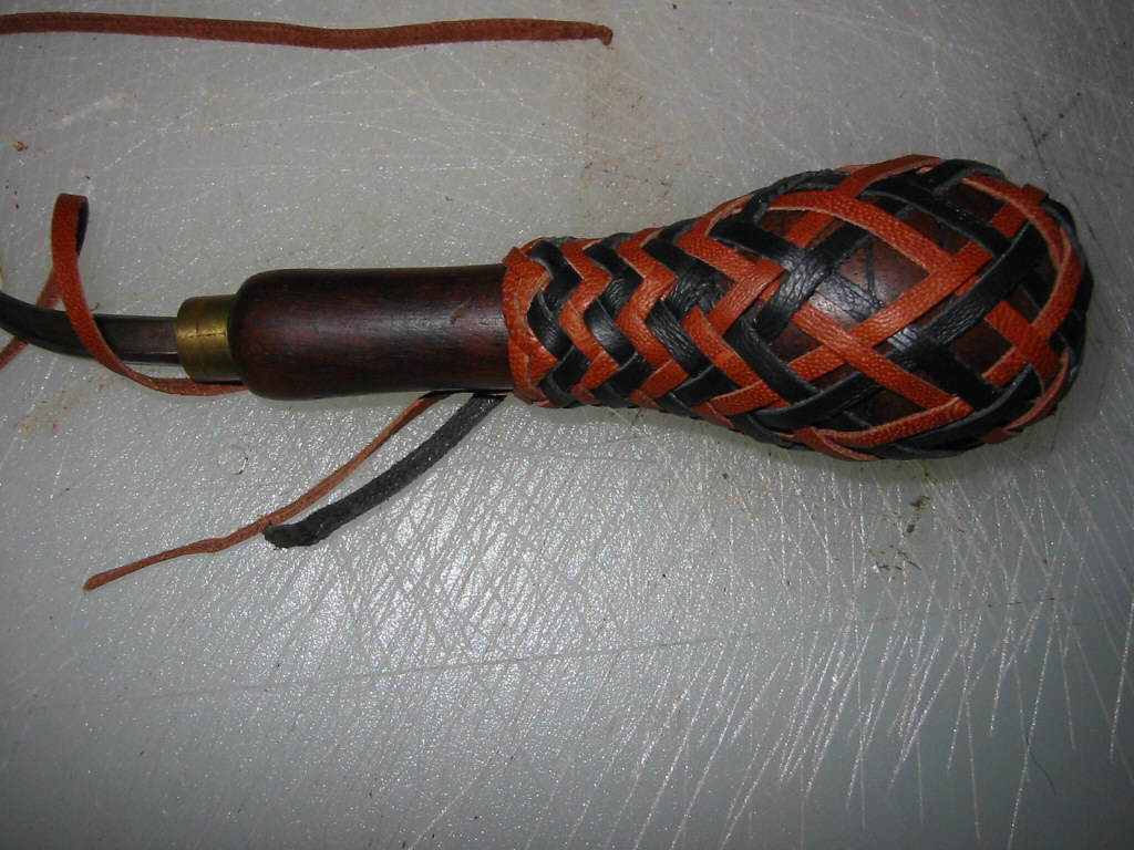

I had a snow day so I thought I would through some roo on a tool handle and take some pictures. This isn't the best tutorial but I hope it helps. First you start with the ground work. I started with a pineapple knot Added the first interweave The second interweave won't go through the whole knot I third and finale interweave I used only goes around the largest part of the handle. The knot is done. That's how I cover my old tool handles! Here is my first tool handle I did. (Make sure you have a cover on the blade before you start) I hope this helps, Post us with your progress
HorseHair: I TRIED reading the Knot Theory page you sent me but my brain started to hurt. Thanks for the effort. Mike: I started braiding tool hands to learn different interweaves and to be able to cover awkward shapes. I hated to un-tie the nice looking knots I braided over a dowel when I first got started braiding. They look a lot nicer on a tool handle or something more practical. I don't braid much these days but I like to grab a tool and wrap some roo around it to practice. The tool in the the photo I start with a 2X long-button for my ground button then added an interweave through the whole button extending the knot at the end of the handle with the interweave thong. The narrowest part of the handle can't support another thong so the third interweave is worked through 3/4 of the of the ground button. A fourth interweave is needed around the largest part of the handle to fill in gaping. My instructions aren't great (Sorry) but a good book to reference is Braiding Rawhide Horse Tack by Robert L. Woolery. Its the best book I have found for different interweave options. Shout back if you have any questions. Hope it will get you started, be sure to post your work. Happy Braiding, Luke
