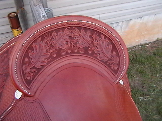

	Wow I'm impressed...nice eyes Bruce...the trees are wood "tuff coated" trees. basicly means a wood tree sprayed with Line-x. I get them made from a tree maker here in Georgia. I know Bowden offers a "tuff coat" but I don't know if it is the same product. It won't peel, crack, or come off in any way. and the coat COMPLETELY seals the tree. A little prep work is required though, Sometime there are drips in the coat and those have to be sanded smooth. If you want MORE info on these trees. just ask. As far as the cantle. again good eyes. The seat is actually a half seat. You don't really see them that way anymore ,sort of an OLD school look. thats what the customer wanted in this case. a blend of old and new.
	Yes, I prefer an all leather ground seat over the metel or fiberglass ground seats whether or not a padded seat is going in.
	first is a saddle that was recently finished, then there are 2 that I'm woring on now. in progress. I will post more pics of the two in progress and ya'll can see them take shape and will post some pics of other saddles and tack that I've made later on so check back. and before you ask those aren't ralide trees they are wood "tuff coated" trees

	these are pics of my last saddle and two that I am working on now, one I have just start to put in the ground seat that other has the ground seat in and I have covered the fork and wrapped the horn. more pics to follow as I complete the next twoposted one pic twice sorry guys heres the one it is supposed to be
