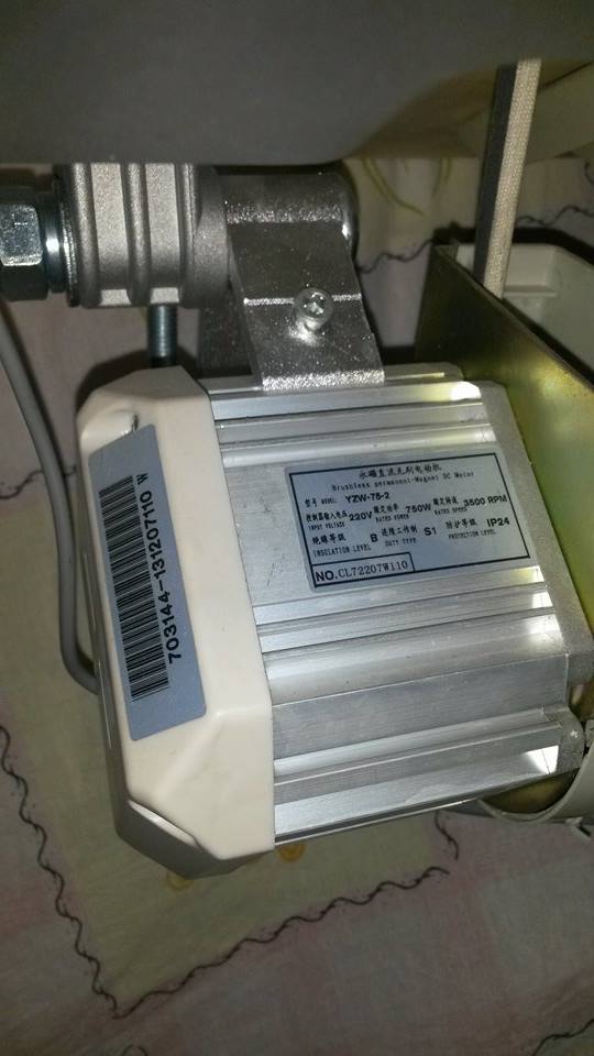

http://www.chinamaqi.com/cn/product/9800.html This is a Mitsubishi 4400 copy.I don't know if there is an Uk dealer for this brand. I have bought one about two years ago and I'm very pleased with it. Brand new with a powerful 750W electronic motor paid 900 euro. -

886€ including VAT,free shipping.I've already bought it...Indeed 9mm stitch,750W servo,from a dealer.Just for fun I have to mention that before contacting the dealer,I phoned to the Mitsubishi dealer from here and asked for a LS2-4400 price.The answer: 5355 euro including VAT...I just hope that the clone will do its job.
Mitsubishi LU2-4400 indeed.So, would worth 880 euro for the Maqi clone?Thank you Constabulary for your help.
Hello leatherworker, I am looking for a triple feed to buy and found this Maqi LS -H4400. Never heard of it and can't find any details other than 9mm stitch length,16mm foot lift, DPx17 needle.Price new with servo motor...about 900$. So is this a Juki copy in the end?Does it resembles to any other model or brand you may know? Thank you.

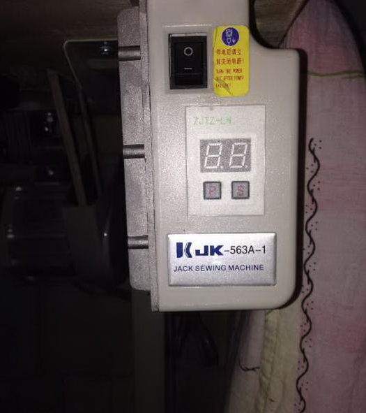

Thank you all for your answers,..I believe I'll go for it.Thinking that the motor only is 130 pounds on "college-sewing.co.uk" plus let's say 20 pounds for shipping would be 130 pounds.About 235 american dollars.So I think that 190 dollars for a new walking foot industrial sewing machine(even if it's a chinese one) is not that bad.For lighter leather I have an old Singer 18-3 which works great,so I'll keep this Jack for thicker leather and other heavy materials.Thanks again.
Hello everybody,...I found to a local seller a Chinese Jack JK-6380 sewing machine,that is supplied with the table and a Jack JK-561A-1 servo motor.The machine is like new still have the warranty until march 2017 only 10 wallets sewn with it.Price-425 dollars.What do you think is it worth it?Thank you.

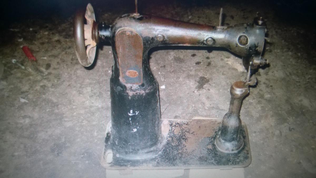

This is a piece of suede leather folded in half, not very thick about 3 mm.The stich length is 5mm(or 5 stiches per inch). And this is how it looks when I've find it in the first place. Next I'm thinking to replace the take up lever with a new one,a new check spring,a new feed dog,maybe clean all the rust and put a new paint on it.All in all I think I've made a good job and should give myself a tap on my shoulder .

The sewing machine is working again. I wasn't able to order the spare parts from colege-sewing uk yet.I've made some improvisations first just to make sure that the sewing machine has the willing to sew.One of the problems was the little groove in the hole of the thread take up lever make it useless.Resolved it with a piece of rubber coat,from a power cord and a screw eye hanger. The next thing to resolve was the upper thread guard.Made it from a piece of steel wire.And find a thread check spring...find one from an old home sewing machine.

Hi,actually I'm from Romania... And I think that the machine is not that old(before the WW1...maybe made between the Great wars).I belive this one is older http://www.ebay.de/itm/151523421399?_trksid=p2060778.m1438.l2649&ssPageName=STRK%3AMEBIDX%3AIT But the pictures are shot in a poor angle as I can't see if there is or not a thread tension spring somewhere. Mine it does have the cover plate,it can be seen in the last picture.And believe it or not I knew about the machine from the link you've shared,and I did ask the seller to post an image with the front plate but he/she ignored me.There were few Adlers that looked like Mansfeld on Ebay Germany but I haven;t saved the auctions to tell what specific model they were. Anyway thank you for your answer and for your time(maybe you have a picture with the spring you said the bottom thread is going under).
