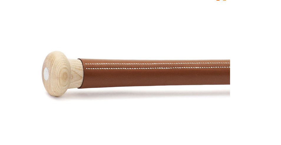

Howdy! I am curious as to what kind of stitching this is? How I find more information about it and if it is suitable for items that are flat instead of round and/or hollow instead of being wrapped... Muchas Gracias!
