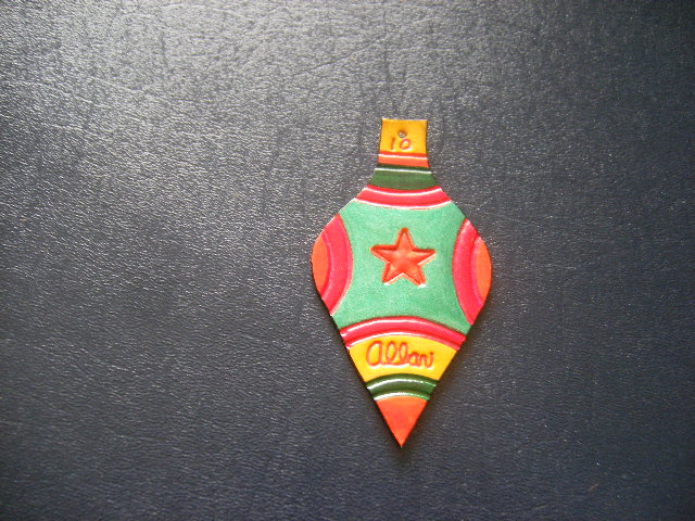

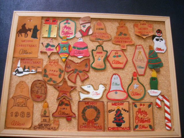

This is my ornament for 2010 in attachment #1. Attachment #2 shows the ornaments that I have made over the years. Merry Christmas! Allan

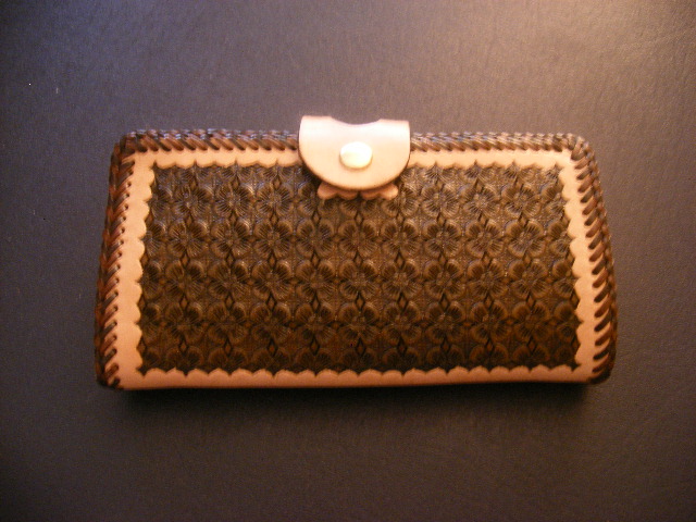

Countess Clutch Purse
alsleather replied to alsleather's topic in Purses, Wallets, Belts and Miscellaneous Pocket Items

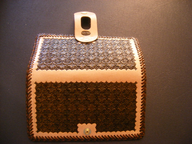

Hello, Only four stamps were used . They are G9009-01,G9009-03,C813 and Midas 303. Allan -
Hi Bob, Thank you for the compliments. On the two tone finish, I applied Super Shene around the border and let it dry,then apply another coat. Usually I let this dry overnight. Then I applied Hi Lite over the entire piece, the Hi Lite only penetrated the stamped area. Take a damp paper towel and remove the excess. Let it dry, then apply a final finish. I hope this helped you. Allan -

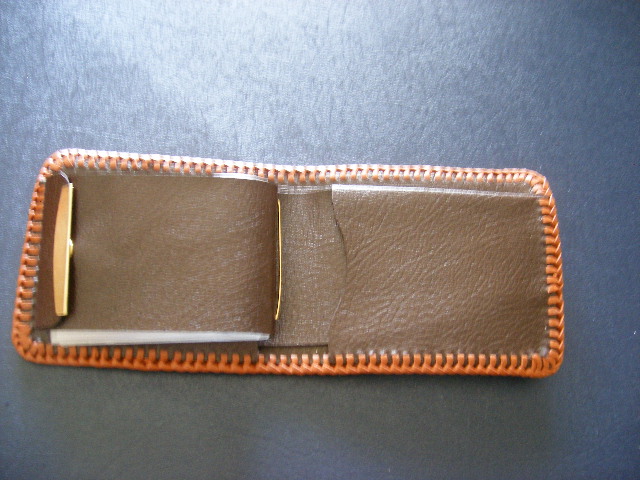

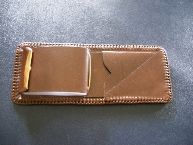

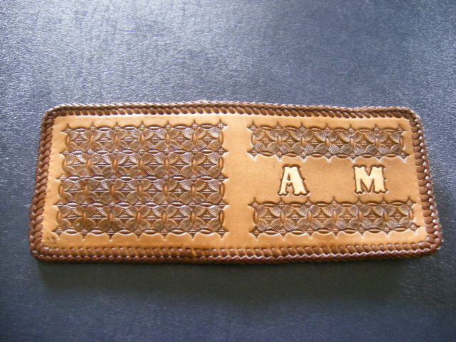

This is a recent wallet that I completed for a customer. Picture 1 is the front view of the billfold with a stamped pattern. Picture 2 is the inside view. I made the billfold from scratch. Allan www.alsleather.com

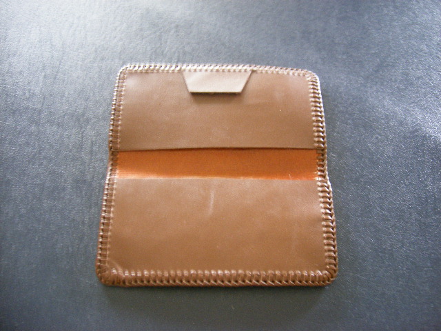

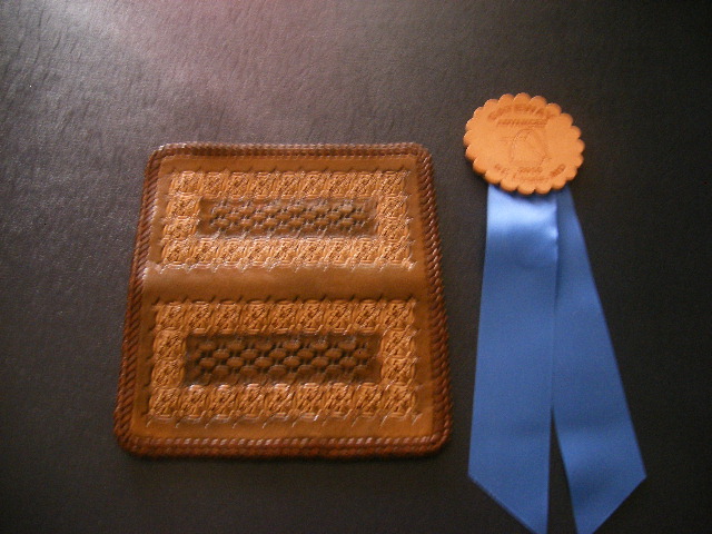

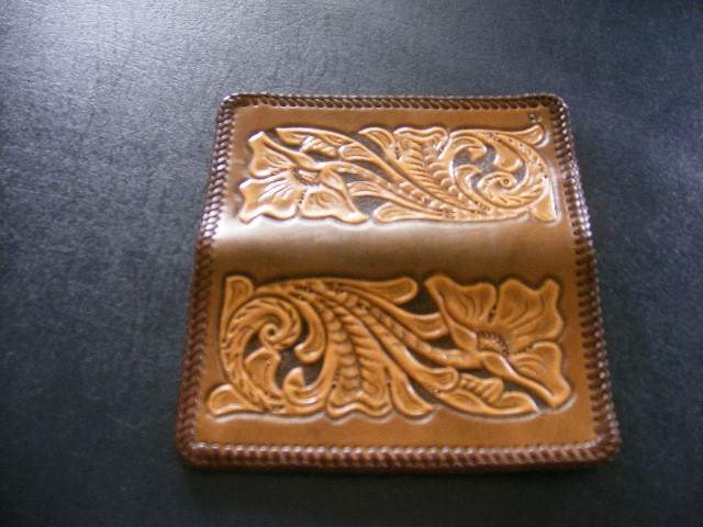

Attached are two Checkbook Covers one carved and one stamped. Also the third attachment shows the isides. I cut everthing from scratched including the back, linning, and pockets. Also I include a tab at the top to hold the check register page. Although I do mainly stamping, I also do carving. Both the carved and stamped covers are a two tone finish which really makes the patterns stand out. I did the double loop stitch on both. I hope you like them. Allan www.alsleather.com
