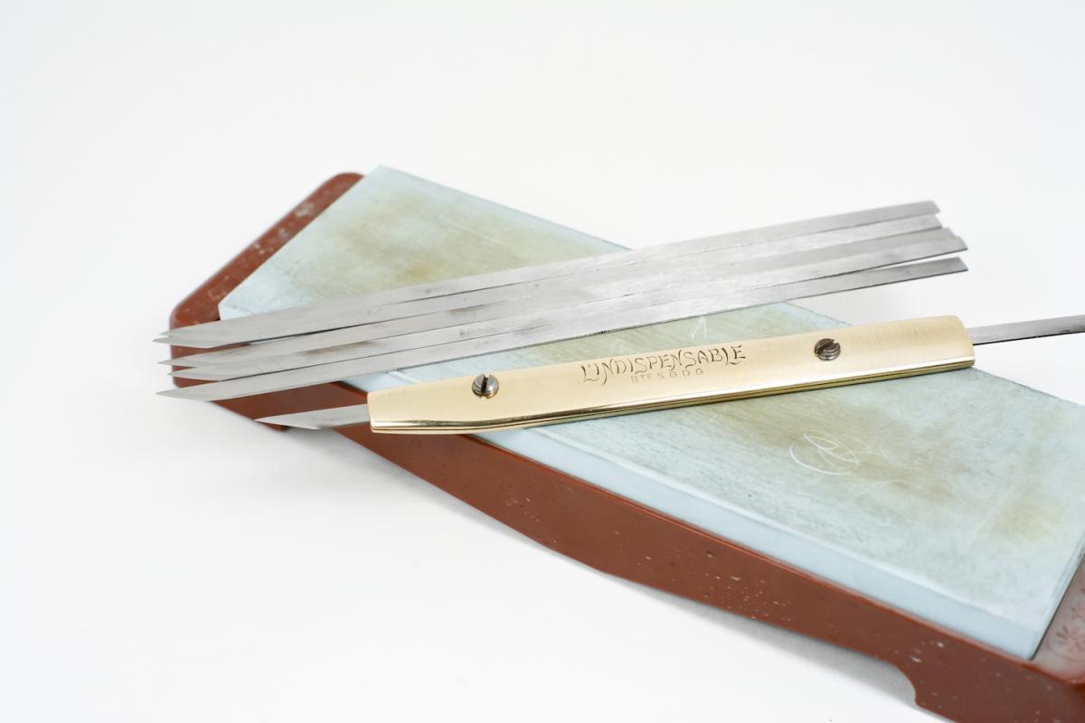

I love the design and concept of the knife, but I felt it was majorly lacking in two crucial departments. The blade steel was entirely too soft, and the ergonomics with the hard edges were obviously not made for a human hand. I have made up a batch of O1 High Carbon Steel blades with a hardness of RC62 (the optimal hardness for O1 as far as toughness and edge holding goes). I have cut out a bifold and a few watch straps so far, and the difference is astounding. The O1 takes a much keener edge and wont roll over, forming a bur at steep bevel angles like the stock one. While I was at the grinder, I took the brass scabbard and re-profiled it. I took out all of the corners and rounded them into smooth transitions. These changes resulted in a whole new rig that kicks ass now. If anyone is interested in a blade, hit me up. They are the bee's knees.

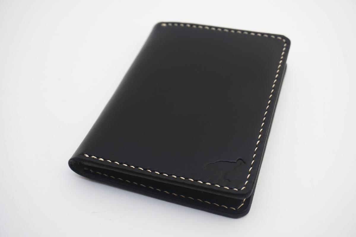

Father's Day Orders
MudBugWill replied to MudBugWill's topic in Purses, Wallets, Belts and Miscellaneous Pocket Items
Thanks for all the compliments yall! JMK Which wallets are you referring to? The dark colored ones are the tannery finish. Thanks Monica, I'll check it out. -
