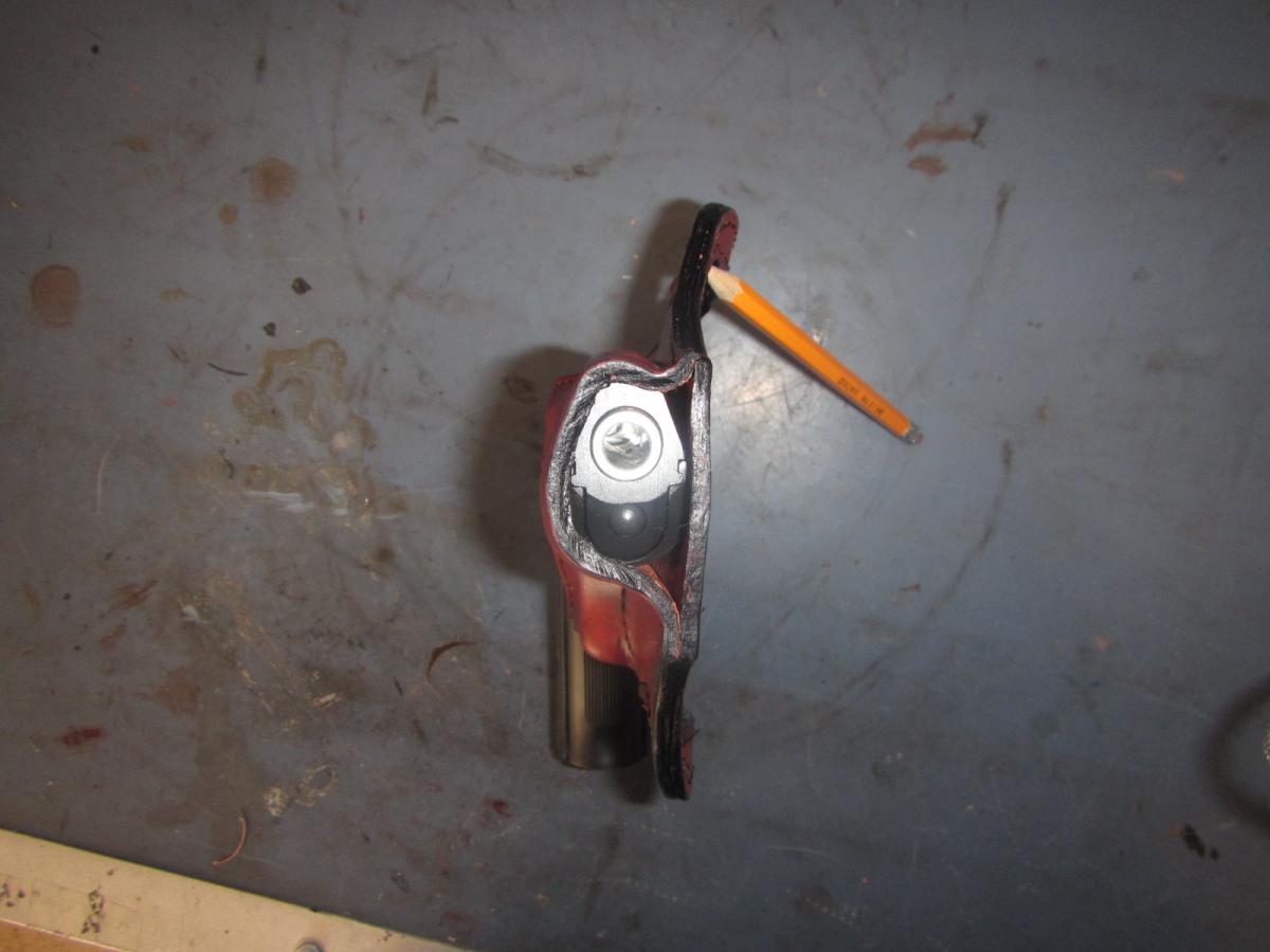

	It may not look beveled in the pic, but it was. I think it's the black edging I used for a final touch (another thing I think looks cheesy). I think it may help if I have my tools out in plain sight and in order of usage.. When beveling the mouth and toe, is it imperative to not bevel the parts that are going to make up the welt? if so, how do you determine that point ? Is it right at the stitching or a little towards the welt or the mouth/toe? Thanks ..
	Thanks for the tip on the flat back holster. I have to admit, I got wrapped up in this thing that I forgot to bevel all together. I did most of it after stitching and staining. I need to concentrate on my order of processes. I did not line this, I just thought the stitching would look good along all edges. As for the toe, another overlook. I think I need to fall back and do a simpler pancake without a retention strap.

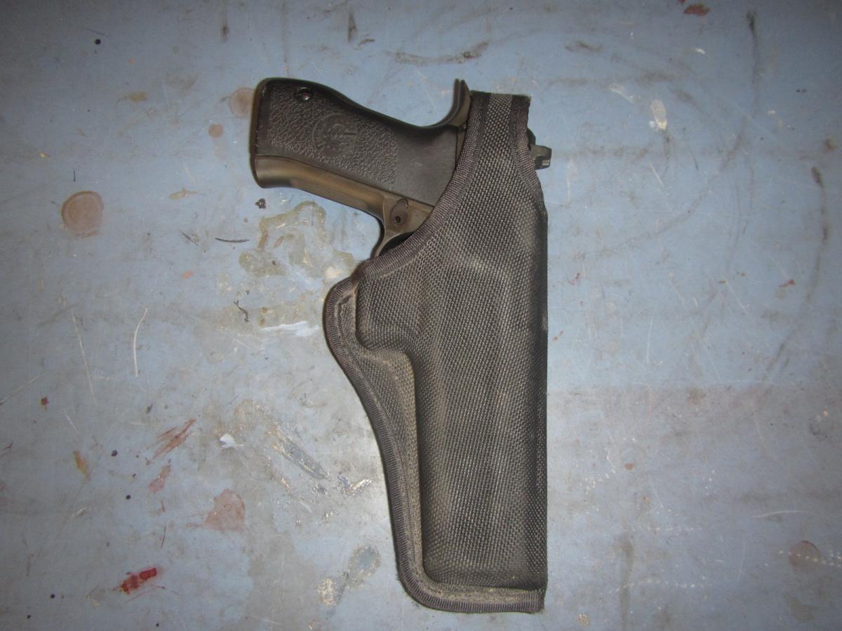

	I have been looking at thousands of pics of holsters before trying to make one. My goal was to replace my Bianchi with a similar leather holster that will not rock or slide on the belt. I am new to leather so please bear with me. I have minimal tools but the collection slowly grows. I have wet formed a few small projects and I can't seem to achieve that "vacuum sealed " look that I want. In reality, my leather looks like I beat it to shape with a hammer. I used 6-8 oz veg tanned leather. Is my leather too thick to get a good fitting form? All in all, this holster came out well and it's something I'll wear when hunting since I won't mind dragging it through the Sonoran Desert brush. The things I like: My stitching is becoming more consistent as I go. I use a saddle stitch with a knot. The holster wears well and fits my contour well. The things I don't like: Fingernail marks Everything else I tried to make this a pancake with the inside as flat as possible by making the outer leather bigger than the inner. It almost worked but glueing the two different sized pieces together was a solid pain. I guess I'll open myself self up to any and all criticism. I really want to learn how to make holsters as a hobby and maybe even a side income of sorts to pad a retirement. Thanks, Pete
