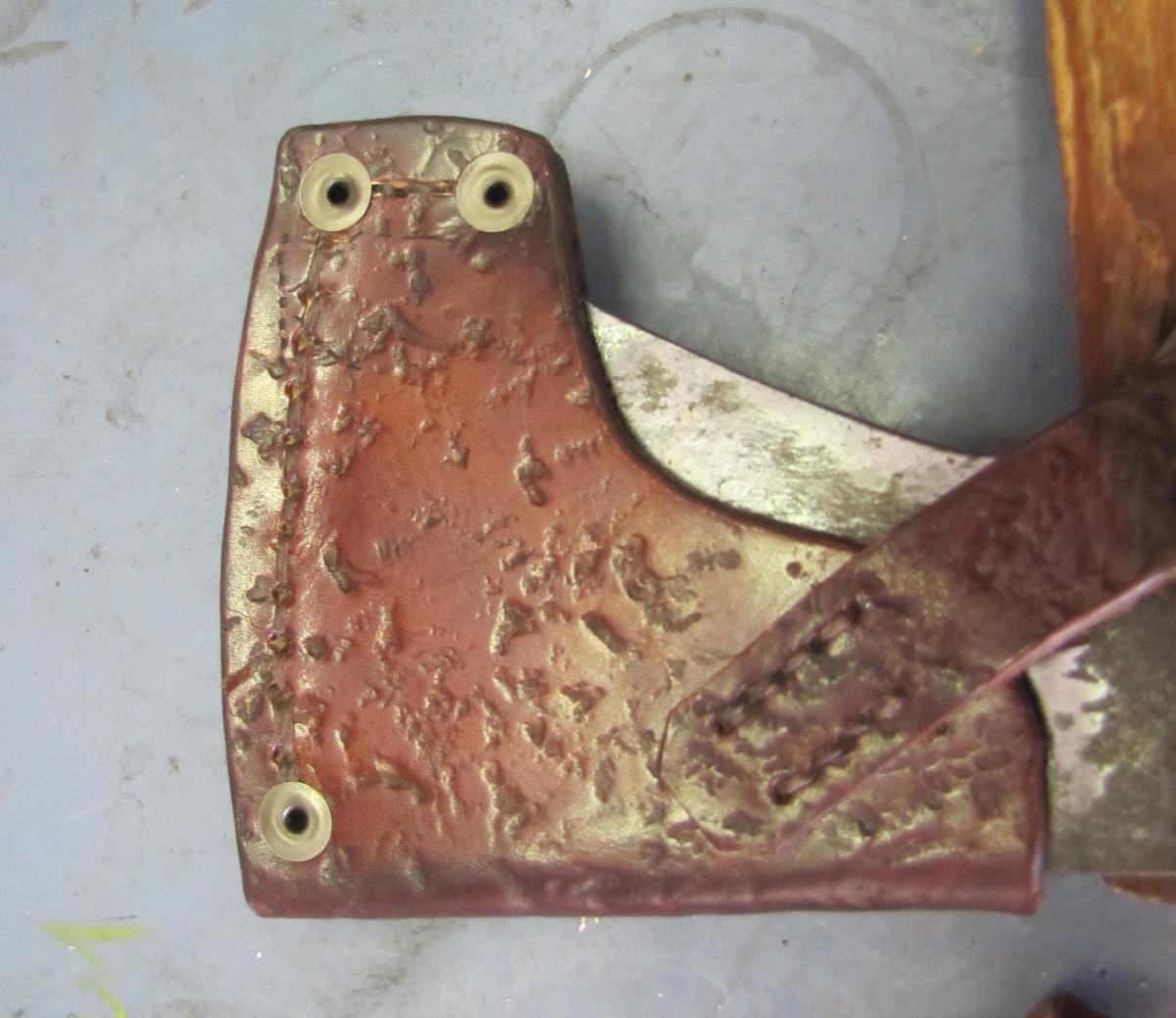

Just getting in to some leather working. Not looking to go pro but just make some of the things I would otherwise buy and repair / replace some of the stuff I already have and ultimately make it a growing hobby. I have a hide from an elk that I harvested and I just can't take a knife to it without knowing what to do with it. So here I am. This is my axe sheath I needed to replace..
