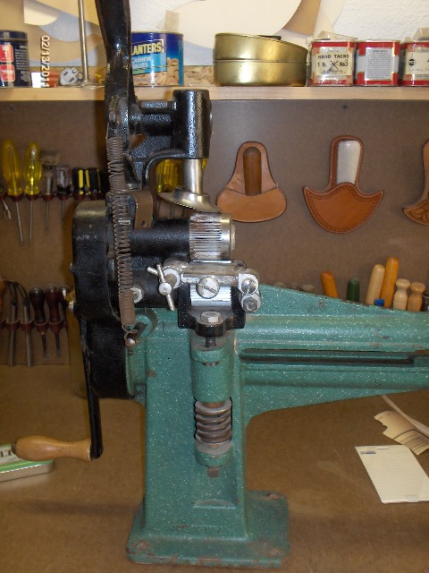

this splitter is a minor fixer, mostly cosmetic. needs a screw on front replaced and a new handle, however neither of these have ever affected the function of the machine. I have used it regularly since 2000 and has been a good machine blade is sharp and ready to use just cleaning shop right now and some things gotta go. $500.00
good machine in fine working order. has a chipped corner on the rear of machine that does not affect function. (see attached pic) priced right at 550.00 plus actual shipping cost.
