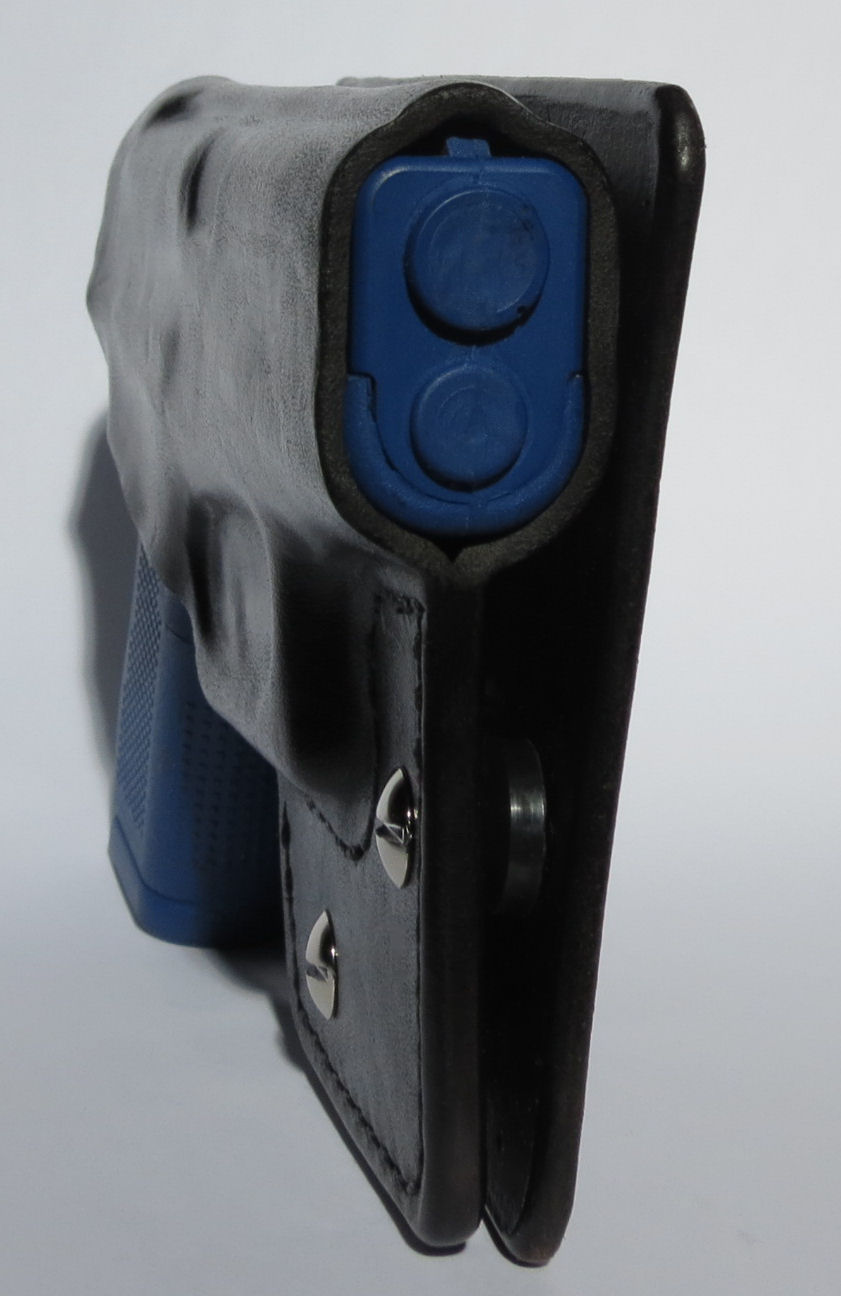

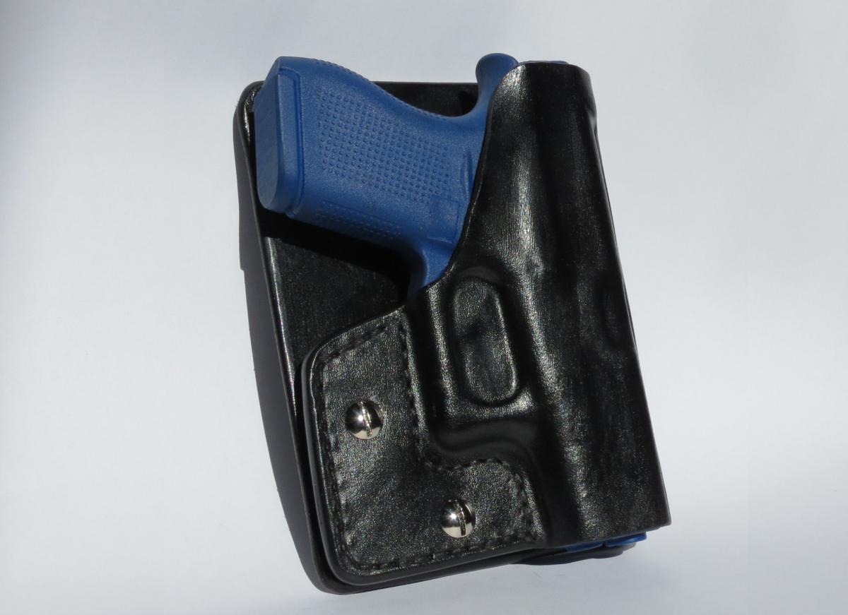

I'm a bit late in this thread, but what did you end up doing? SoB holsters are VERY popular among law enforcement. I was police officer years ago and I carried a Beretta 92fs in a horizontal Galco SoB holster off-duty for several years. The whole thing about breaking your back if you fell is pretty much an urban legend. Been there done that and survived without a broken back after being tackled by a drunk 325 pound redneck. The gravel I went down on hurt MUCH more than the gun in the holster. If it's concealed properly, there's no more risk of it being taken than a side holster. I hate the new Galco SoB holsters, so I went back and recreated the original horizontal Galco design except with a bunch of improvements over the original that make it safer and more reliable. The picture is of my wife with one of my SoB holsters and her M&P Shield. -
Thanks for the compliment... this turned out to be my best selling design in several different models. The best way to draw from this is to either allow the back plate to catch in the pocket, or use your thumb to push down the holster as you're drawing. Out of all that I've sold, I've had one complaint/return - which I found out from the feedback he left others, he was impossible to please. I agree, the 42 and 43 are too big in my opinion to be pocket guns, but I sell quite a few of them.

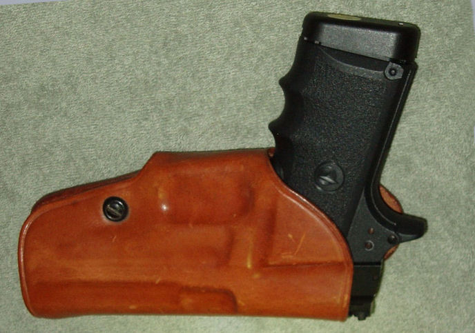

I read a lot of posts that warn about the danger of a SOB holster. I wore a Galco classic SOB for years off-duty, with a Beretta 92FS, and had no problems. I was slammed and pinned by a 350 pound pissed off drunk guy, and didn't sustain any back injuries except for the gravel that dug into my back. Frankly, the cuff case over my appendix hurt more than the holster did. I would personally recommend grip up just to avoid sweeping ones own body, but if the wearer is very thin or flexible, I could see it working - but with a bit more awkward draw. Also in that position, I think it will be too high on the back, and that significant printing is a risk. The image below isn't my holster, but it's exactly like the one I had. The frame of the gun was almost parallel to my belt, maybe with a 10 to 15 degree cant. I prefer this design over the current Galco SOB holsters. -
