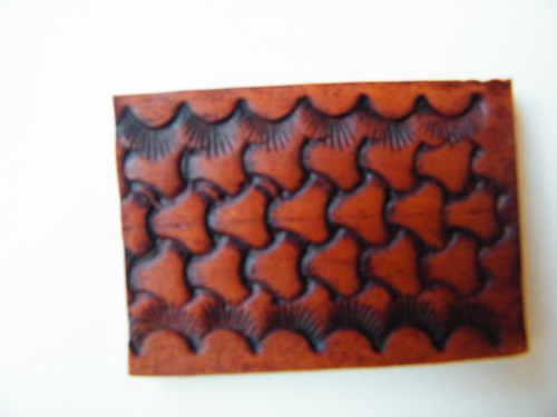

Usually I don´t want to dye the piece completely. I try to get the colours of those sheridan carvings: natural leather tan with darker impressions. I`m after that slightly yellowish-golden brown with darker brown in the impressions that I like so much. I also had the idea to dye first and then apply the antique, but to me happens what you describe: It gets too dark all over. Some interesting result I got when I diluted the dye with Tan-Kote, but I am not convinced. There are some belts in the instructional videos from Tandy with George Hurst which I like very much, but apart from the stamping I can`t get the colour . The leather I use is veg tanned in France and imported to here (to Spain). Actually I don`t know if the cuality is good as I can´t compare to leathers from different tanners. Allover dying the leather gives very good results. For this purpose I use the spanish brand spirit dyes they use in the shoe-production. I can buy profesional dyes of ANY colour paying 6,50$ for 17fl oz. Very cheap compared to Fiebings or Tandy....... I go there with an example of the colour I want and they produce it just for me. BUT, they don´t know much about the antiquing technics and therefor I have to keep on searching the products I need at Tandys or Fiebings. By the way: My local Tandy Shop doesn`t offer the antique finish from Fiebings. Is the Eco Flo Gel Antique a good choice too? I bought Eco Flo Gel Antique saddle tan and it is just absolutely ugly. I can´t use it. It turns out a reddish orange artificial colour that is just inacceptable. Wuuaaaah.... Now I found out that I can put the stamped belts out to become sun tanned before applying the antique. One or two days in the sun will put a better ground colour to the leather. Before turning the leather out I apply spanish foot oil (pata de buey). I noticed the the leather sun-tanns even under a coat of Tan-Kote. Thank you for your answers, if I find my desired results, I will keep you informed.....
