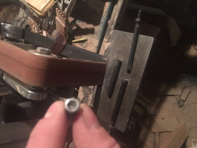

Glenn, to be fair to nicosew, I bought this off ebay. That said it was purchased in 2011 by a company that sews patches onto boots. Apparently it didn't work for them and they only attempted to use it once. I believe that because it came with the original paperwork and inventory and one needle was missing from the box and it was in the machine. The rod that runs the shuttle should be a one-piece solid rod, not the micky mouse construction as it was built. Maybe they had problems with their supplier, nicosew no longer has their own branded patcher, they sell someone else's. This machine also has a needle wobble imparted when you rotate the presser foot that I haven't solved yet. All in all I wish I didn't buy the machine. The steel stand is a beast and the servo motor is great and it seems to be well machined, for example I can't feel any play in the needle bar and I can usually feel 5/10,000ths or so if its there in a machined part. I think once I get it "blacksmithed" into shape and running good it will be ok. I have access to more tools than an average person however. This experience is one I learn over and over in life, you get what you pay for, buy good and it only hurts once. Since I'm in the Midwest, if I had it to do over again I'd just order a cowboy.
My machine kept going out of time every time I got a tangle on the bobbin. Since I was playing with thread from 62 to 138 and trying to get the tensions right I had several. Turns out the Way it was made, a piece of 3/8 hex rod runs the shuttle rotation. The hex rod was in two pieces, drilled and tapped with a pot metal 1/8 inch stud right in the middle. It was bending and finally snapped. The screw wasn't even lined up with the hole in the casting. What a dumb modification to weaken the 29 original design. Rather than turn down a new piece of hex rod and recut the threads I cut the ends off and will weld in a section. I'm making sure the screw hole in the casting will line up with the hole in the casting. Should be back to sewing again tomorrow. So if your 29 clone is a flopping out of time take a look underneath, at least it's an easy fix if you have a metal lathe or a mig welder.
