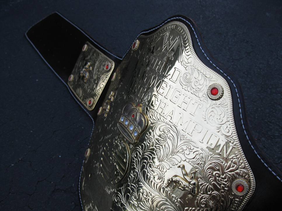

I make Championship Belts like the ones used on TV by big companies. The majority of my work has been replicating the straps that those who have come before me have done; replicating their style. I am trying to come up with new/unique ways to tool my belt straps, without turning them into long, laborious projects. Due to the amount of orders I get and the expected turn around time, I'm lucky to have a few hours to work on a single strap. While many of the intricate designs of traditional leatherwork would be great on a strap, the customers simply aren't going to pay for the labor. Attached are some different tooling styles I have been plating around with. I guess I'm at a road block and looking on some advice on some different stamps, techniques or designs to incorporate into my work. Thank you Insert existing attachment Due to the size limit here, my full gallery is available on my website, BeltsByDan.com

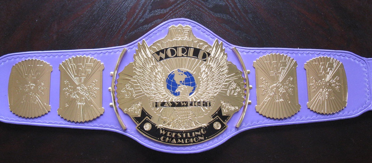

I am working on a project and looking to come as close to this color as possible. I would call it lavendar. It looks like an acrylic topical, not a dye. Is anyone familiar with anyone who makes a color as close to this as possible? Thanks; Dan
