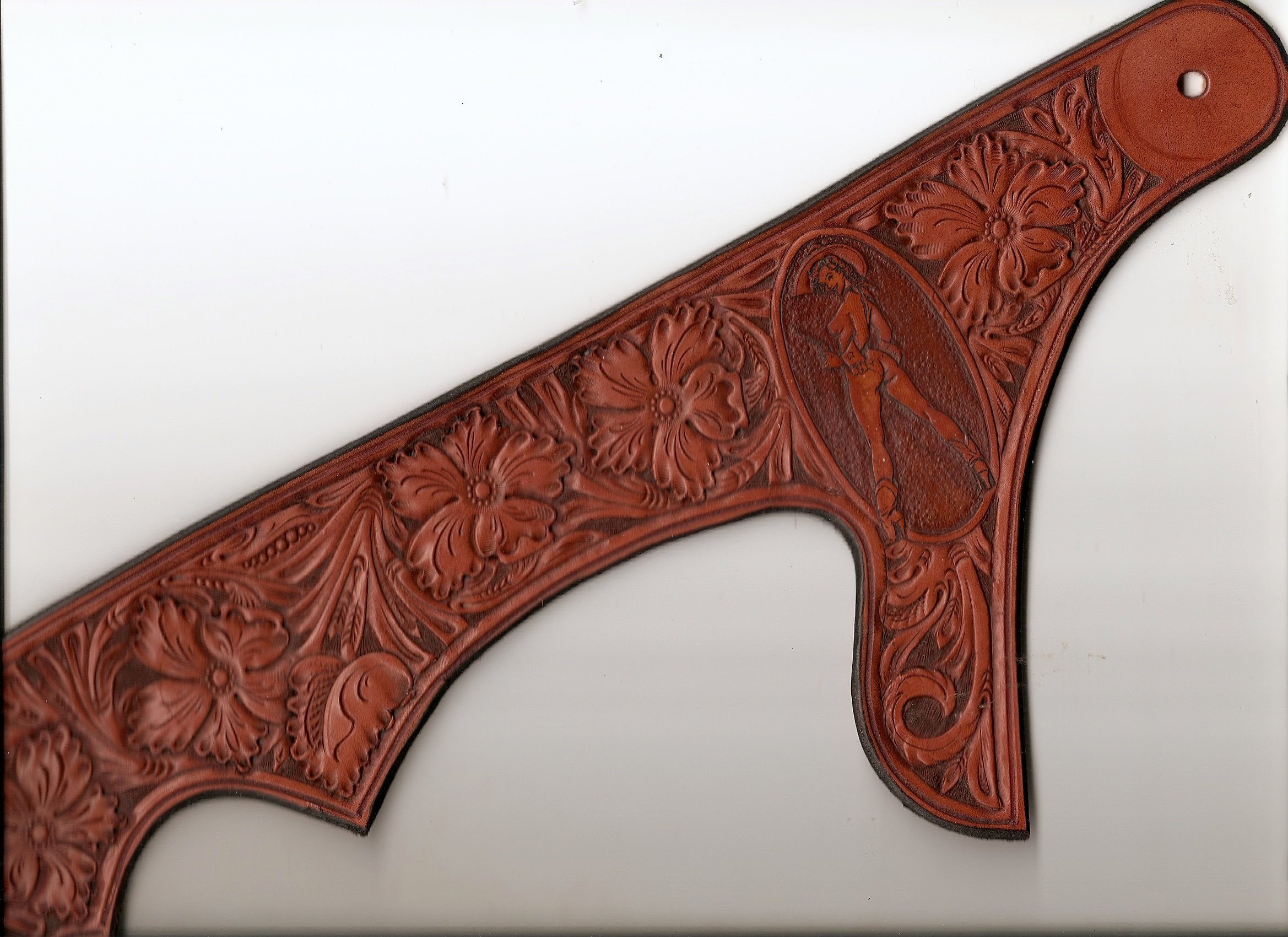

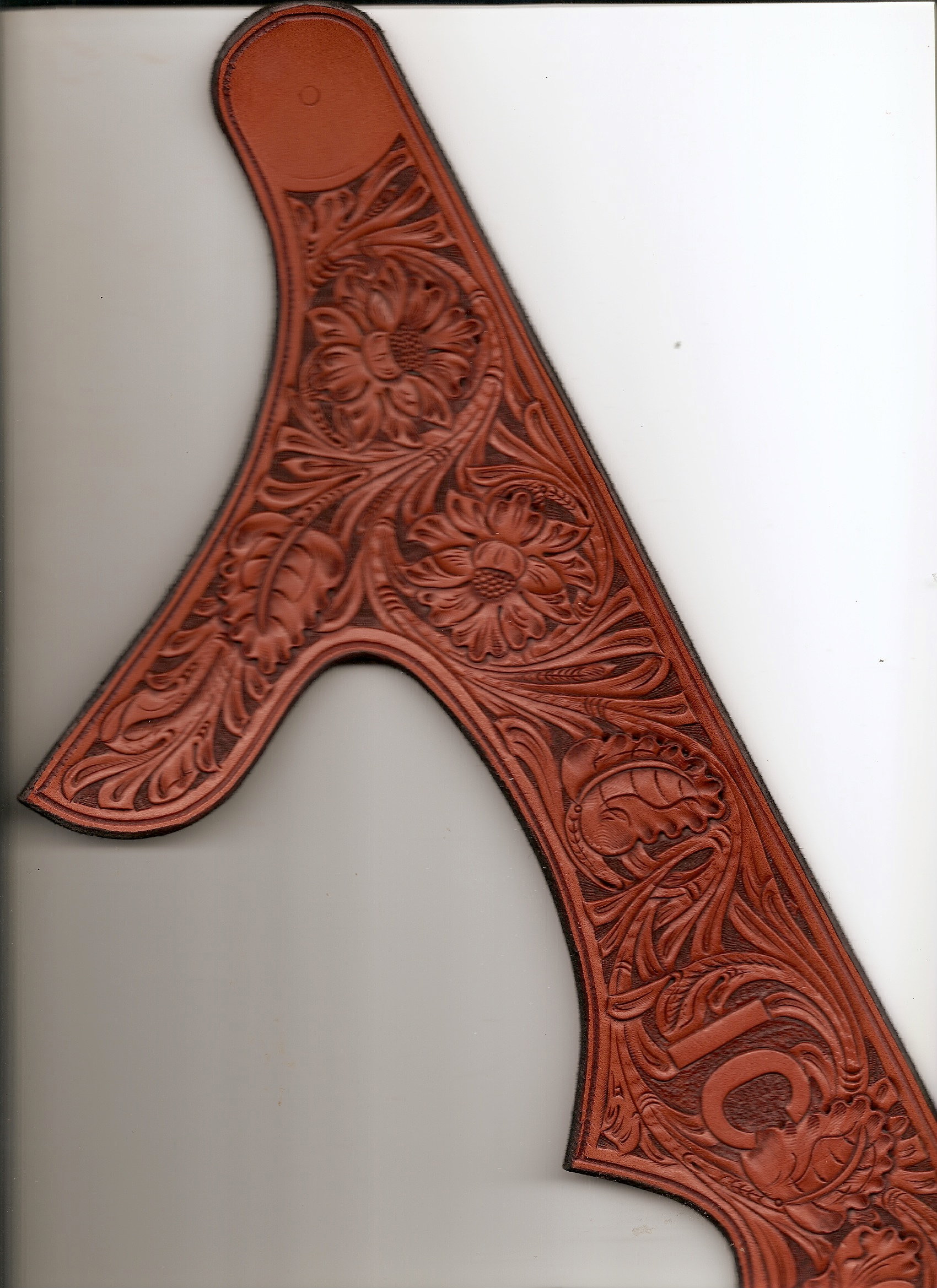

	I scanned these, rather than took a pic, which is why they are in two sections! Another chap top for a reiner customer's shotgun chaps - his chaps will have a twisted fringe when done...will take pix of all and post when finished.
