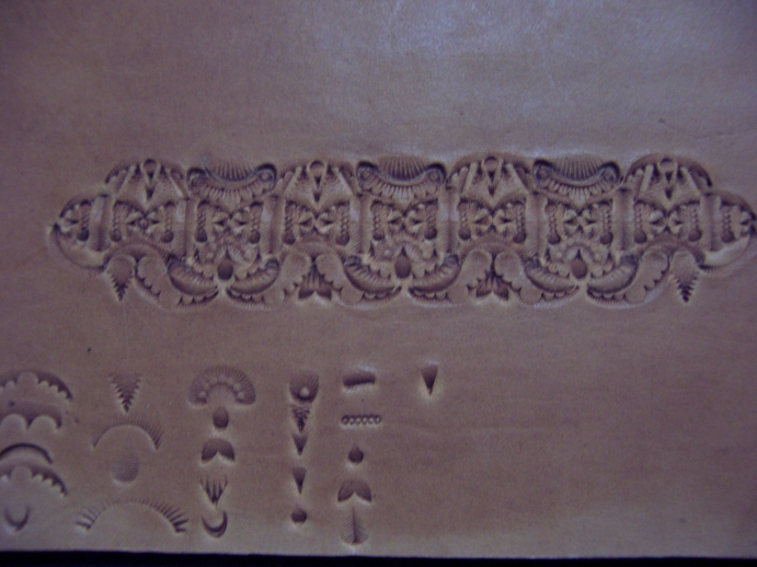

Heres the stamps i used in that pattern . left to right , starting top left . I think thats the order they were done . some were used more than once in different areas so i didnt put em in again . sort of stuffed up the sequence though . 37 stamps plus a dot from my modeller . I'd like to do a sequence , but it will take heaps of space , any ideas how on to do it easy ?

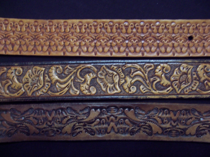

3 very old belts , about 20yrs old at a guess . A quick pattern I just did then with stamps used , in order , starting from left column . Any comments positive or negative would be appreciated . Second thoughts , dont worry about the negative ones !
