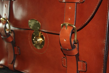

I also like to follow the mechanical and functional into the artistic. If stitching or riveting needs to exist and is done with thought and consideration, the outcome should most likely be artistic. Here's my latest bag. I'll call this one the Walden Diplomat. Prior to stitching, I'm like a slalom skier visualizing the course in my head, where I want to turn, how I want to incorporate the hand backstitching so that whatever is done on the right side is also done on the left, etc. ed
