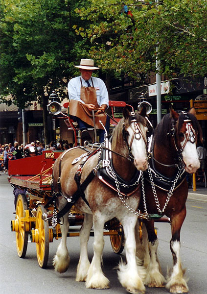

Contributing Member barra Posted February 28, 2008 Contributing Member Report Posted February 28, 2008 (edited) Jim. Thanks for the trip down memory lane. Hand rolled hemp threads rolled on a thread apron made from an old sweat flap and old belt. As an apprentice i was the sewing machine and knife sharpener and can honestly say I have fond memories of stitching gig traces. When you can stitch 4' an hour at 8 SPI (neat and NO dead sailors) then you can hand stitch BOY. I used to look at the clock and go like the wind for an hour and then measure the distance and keep trying to better it. I'd have all my threads pre made and just have to put on the needles. He could stitch accurately and consistantly with no prick marks (just by eye). Something to aim for BOY Now while I did not make the actual set in the attached pic. When I was an apprentice we made some of the original harness for the this teamster Barra Edited February 28, 2008 by barra Quote "If You're not behind the Troops, please feel free to stand in front of them"

Contributing Member barra Posted February 28, 2008 Contributing Member Report Posted February 28, 2008 I'm from Adelaide South Australia and learned from Ken howard. the pic is of the Coopers brewery clydesdales and Mike Keogh Barra Quote "If You're not behind the Troops, please feel free to stand in front of them"
