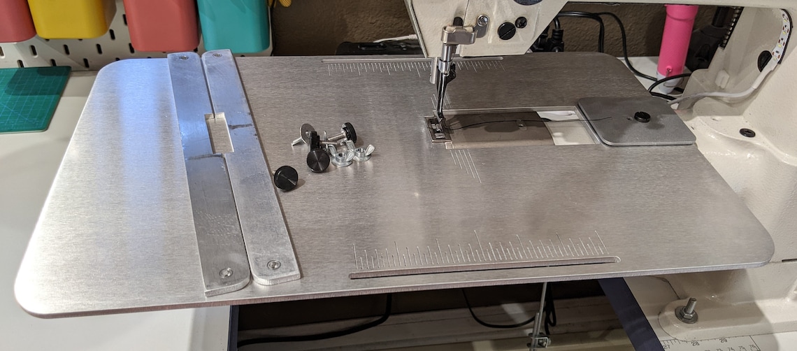

MtlBiker Posted January 17, 2024 Report Posted January 17, 2024 3 hours ago, toxo said: I'm getting excited now. When It got to the details of what I was getting they quoted JL-1341L. When asked what the "L" was for they said it's for the large bobbin which is 28mm. So on the face of it that's good right, but does that mean they're harder to find? I've already asked if they can supply spares but I think they've finished for the day. They also do a table attachment that looks good, and big, for $85. Just wanted to drop a comment about flatbed table attachments... When I got my Techsew 2750Pro, it came with a table attachment. It was AWFUL! It needed 2 (or was it 3?) threaded rods to be inserted in the table and adjusted in order to support the table. The process of installing and removing that attachment was a really unpleasant one and certainly not something you'd want to do every day, and certainly not several times a day. Then I found (on eBay) a really nice aluminum table attachment that installed with ONE screw! Easy Peasy! It goes on, no adjustment required, or off in easily less than a minute. It is wonderful. I hope that the attachment you're getting will be as good. A bonus on the table I got is that it included two flat guides which could be positioned left or right of the needle and tightened in place with wing nuts. For holding an assembly in the right position they're wonderful, and I often use the right side one (not the left). Many (most) aluminum table attachments I've seen don't have that. Quote Current machines: Janome HD3000 and Skyline S5, Consew 206RB-5, Singer Profinish serger, Techsew 2750 PRO, Sailrite LSZ-1 Premium, Consew DCS-S4 Skiver

MtlBiker Posted January 18, 2024 Report Posted January 18, 2024 (edited) @toxo - I can't see from that photo how the table attaches. Here's a photo of the table I got from Etsy: There's only one screw holding it (tightly) in place. That's at the right with the little top plate. I can't imagine an easier or faster to install or remove table attachment. Edited January 18, 2024 by Northmount Copied source file and uploaded here Quote Current machines: Janome HD3000 and Skyline S5, Consew 206RB-5, Singer Profinish serger, Techsew 2750 PRO, Sailrite LSZ-1 Premium, Consew DCS-S4 Skiver

toxo Posted January 18, 2024 Author Report Posted January 18, 2024 1 minute ago, MtlBiker said: If you'd looked at the URL for that image, you'd have seen it was from Etsy. I think the search was "aluminum table attachment". When I looked it up it wanted the size as the generic style of the machine, ie, Juki 341 or Adler 69 etc. I daresay it's easy to sort out but I've just come away from a 1341 that turned out to be a Mitsubishi and I'm now looking at a "341" which is a clone of ???. Just nit picking and Easy to sort out but if it's only one screw can you be sure the machine has the hole in the right place? Quote
MtlBiker Posted January 18, 2024 Report Posted January 18, 2024 29 minutes ago, toxo said: When I looked it up it wanted the size as the generic style of the machine, ie, Juki 341 or Adler 69 etc. I daresay it's easy to sort out but I've just come away from a 1341 that turned out to be a Mitsubishi and I'm now looking at a "341" which is a clone of ???. Just nit picking and Easy to sort out but if it's only one screw can you be sure the machine has the hole in the right place? As far as that aluminum table attachment goes, if you look closely at the photo, you'll see there is a cutout on the right end of it. That fits over part of the machine's cylinder arm. Then another small plate goes on top which is used to secure the thing down. The hole in the machine can be quite varied as the plate can be positioned where the screw hole is. What would be of more concern is whether the cutout on the table actually fits the machine. For that I can't help you but I'm pretty sure if you contact the seller with the make and model of your machine they'd be able to tell you. Good luck! Quote Current machines: Janome HD3000 and Skyline S5, Consew 206RB-5, Singer Profinish serger, Techsew 2750 PRO, Sailrite LSZ-1 Premium, Consew DCS-S4 Skiver
