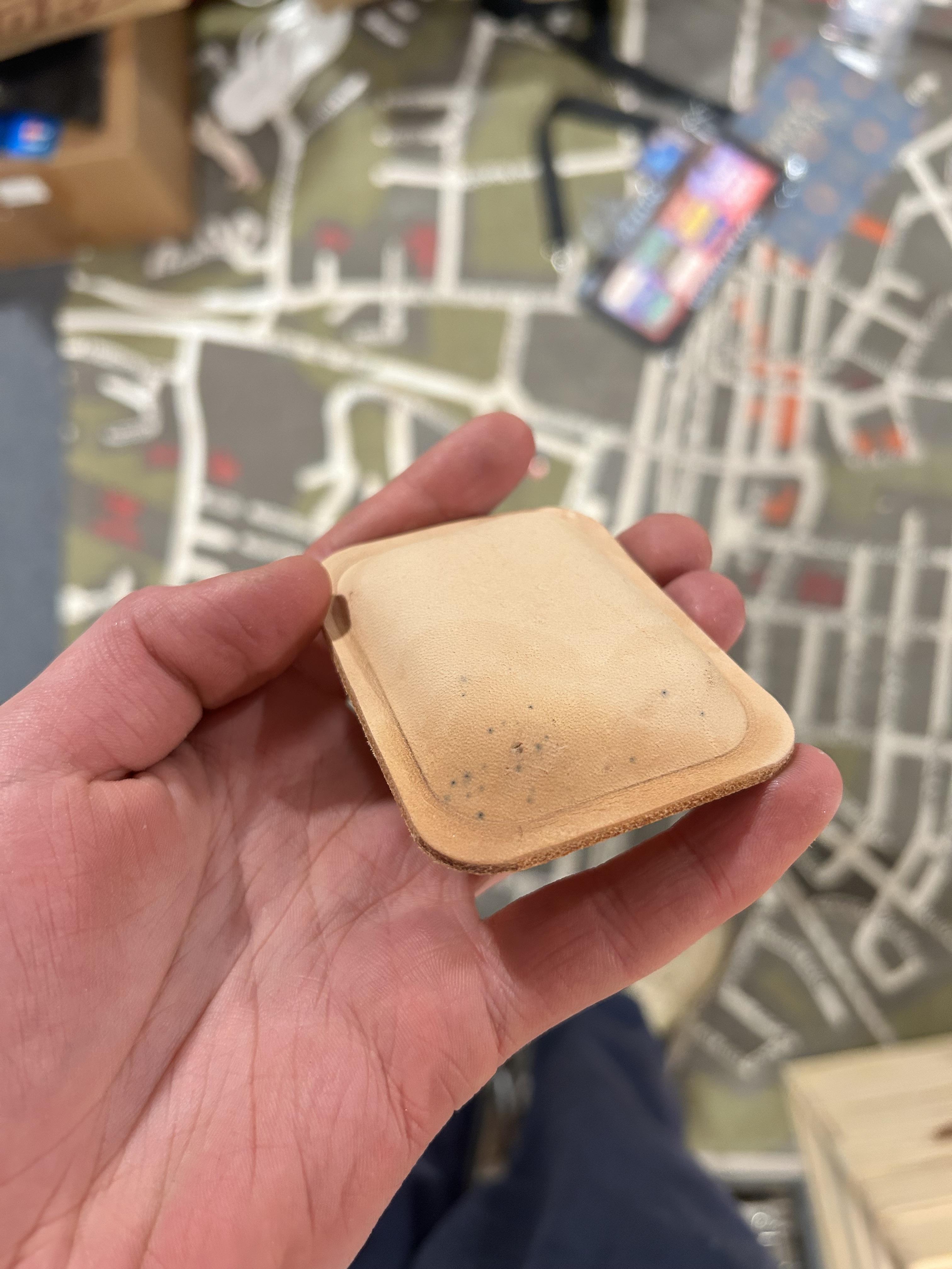

Members medievalbard Posted April 26, 2025 Members Report Posted April 26, 2025 I know this has been asked thousands of times, but bear with me. I recently bought a very large undyed unfinished double butt piece of leather from Tandy. I usually work with pre-dyed, prefinished leathers, but I figured I’d take a risk and learn how to die and finish leather myself. However, an unexpected issue that has risen is that before I can even get to finishing/dying, mildew/mold begins to form on the belt on both sides, very soon after I finish stamping a design(I’m talking under an hour). What on earth do I do to make sure this doesn’t happen? This also happened with the same leather when I attempted to wet form leather around an AirPods case and when I clamped a piece of leather to make a key tray. The mold in question is little black spots, that don’t smell or feel strange, but are definitely very noticeable. Could it be because I soaked the leather overnight? I usually only soak it for an hour or two, but I had some extra time so I wanted to see if it’d make a difference. My basement is fairly low humidity, and I have a dehumidifier running constantly set to about 45%. I tried rubbing it with diluted alcohol, but that had little to no effect. I’d appreciate any and all ideas! Quote

AlZilla Posted April 27, 2025 Report Posted April 27, 2025 There was a similar issue here maybe 6 months ago or more. The consensus was that some kind of metal fillings had contaminated the hide, if I recall correctly. The vendor replaced the hide. That makes more sense than mold forming in an hour or two, I'd think. Even over night seems too quick for mold. Quote “Those who can make you believe absurdities can make you commit atrocities.” - Voltaire “Republics decline into democracies and democracies degenerate into despotisms.” - Aristotle
Moderator bruce johnson Posted April 27, 2025 Moderator Report Posted April 27, 2025 Agree with AlZilla. Metal contamination. You can clear it with an acid treatment. The metal flakes interact with tannins in the leather when it gets wet. Diluted lemon juice wiped on or oxalic acid. Most hardware stores sell oxalic acid as “wood bleach”. Dilute 1 teaspoon into a pint of water and sponge it on. The source of the metal can be anywhere from the tannery to your shop and tools. If you handle a steel tool and then wet leather sometimes that is enough to make specks or smudges. Particles falling off a tool can do it. Quote Bruce Johnson Malachi 4:2 "the windshield's bigger than the mirror, somewhere west of Laramie" - Dave Stamey Vintage Refurbished And Selected New Leather Tools For Sale - www.brucejohnsonleather.com
Northmount Posted April 27, 2025 Report Posted April 27, 2025 Definitely not mold. If you do a search, you'll find this has come up a number of times and has been answered by me and others. Can be very disheartening when it happens. Oxalic acid (as Bruce says) is a good remedy, as long as there isn't a piece of iron/steel buried in leather, possibly from a band knife during a splitting operation. Takes a little longer to show through than when it is on the surface. Pattern was traced on and all the swivel knife work was done when it showed up the next morning. It was in a 1" wide border area, else I may have been able to hide it with some tooling and dye or paint, especially if it was in the back grounding. Search for blue, black gray spots. It's the same process as vinegaroon. Quote
Members medievalbard Posted April 27, 2025 Author Members Report Posted April 27, 2025 Interesting! Metal contamination hadn’t even occurred to me. I use an arbor press for repeated stamps on some of my straps/belts, and the side of the wet form that had the specs was a side with a bare steel clamp, so that could definitely be it. Thank you all so much! Quote
