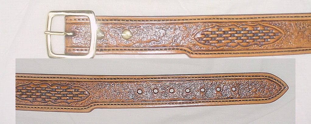

I began stitching a couple stitches on the single layer at the buckle end and continued through the double layer and all the way back around. Ending the backstitch in the double layer.
These are pics of my first belt up close on the buckle end. You can see where the stitching starts. Also there are several ways to get the keeper on there. Since I wanted the basic thing built I went ahead and used a staple to form the keeper and looped it over both layers. So it can be replaced if it tears apart from the staple. Another way is to install the keeper between the two layers when you stitch. This lakes the backside of the belt less bulky and lumpy. The stitching may be tricky though getting under the keeper, at least on the closing side. If you're completely closing the buckle end off, then you can stitch the flap to the layers. I don't. I secure it with the chicago screws you see there.
Sorry about the blurry pics.
I've been wearing this belt since Nov or December. So it's been used, dinged, rubbed and dirtied. While not the prettiest anymore, it has held up well. It's also conformed to me as you can see in that pic. It use to wear like I had a hoola-hoop in my jeans :rofl:
