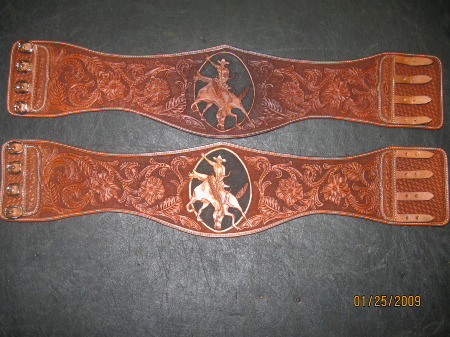

Moderator Crystal Posted June 22, 2009 Moderator Report Posted June 22, 2009 Hi All! First let me give a big "Thank You" to everyone that I have pestered with guestions on this project! I couldn't have done it without all of your help. Lots of boo-boo's, oops's, and one really big that I managed to hide. Still need to get better with my edges and my sewing. Ahh, that sewing, somehow I get it okay on the front side and messy on the back side. I will get it figured out sometime. As always, I am open to any critiques, "shoulda done's", or "ought-to-do's". Thanks for looking! Crystal Quote

Members badger Posted June 22, 2009 Members Report Posted June 22, 2009 Really nice piece, I love the colours. Only two things, since you asked for a critique 1. Stitch around the slot where the holster comes through the drop-loop. This is a high-stress area and will probably come apart eventually if just glued. 2. The main belt keeper, the large one, can be skived down and inserted and stitched between the two layers of the main belt so it isn't visible on the front. I prefer this personally, but it's a matter of taste. Really nice job though. Badger Quote
Moderator Crystal Posted June 22, 2009 Author Moderator Report Posted June 22, 2009 Really nice piece, I love the colours.Only two things, since you asked for a critique 1. Stitch around the slot where the holster comes through the drop-loop. This is a high-stress area and will probably come apart eventually if just glued. 2. The main belt keeper, the large one, can be skived down and inserted and stitched between the two layers of the main belt so it isn't visible on the front. I prefer this personally, but it's a matter of taste. Really nice job though. Badger Thank you, Badger! Stitching around the holster slot is something I will do. I was having a problem with the holster flap fit the way I had originally made it. I finally fixed that problem so everything would fit thru the original slot - but until that point I was leaving some wiggle room to make the slot wider. I will use your suggestion for the back keeper next time. I didn't like the bulk either with that, and just couldn't think of another way to go with it. Thanks again! Crystal Quote
