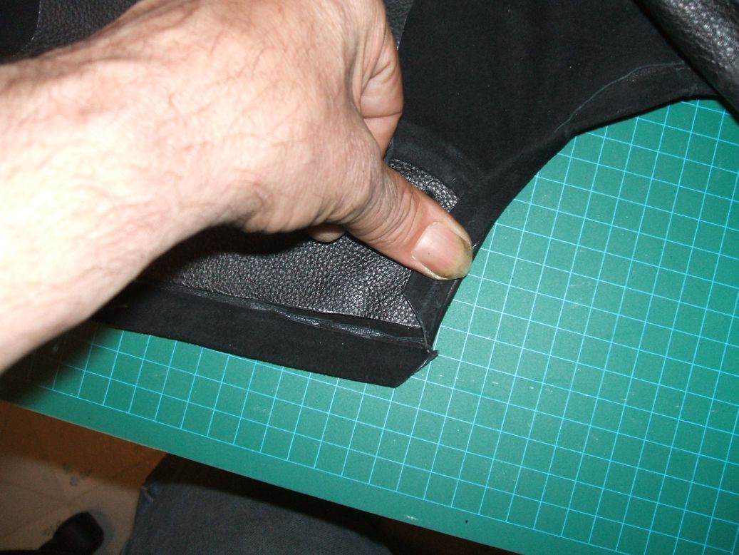

Let's make a pocket now. This is fairly simply to make, yuou'll need some "Pigskin Suede" to line the pocket with.
Using the pocket template, cut out a piece of your garment hide, then cut a similar piece of suede except this is 1" shorter as seen in the picture. You can cut 2 of each as there is 2 pockets.
Then place a bead og glue all around the edge of the suede liner, and also the edge of the pocket front. On the front the glue bead only goes across the top of the pocket 1" down from the top. Once you have placed the liner onto the front, press them together untill they align up and roll with your roller. If there is any overhang of liner, just trim it off with your scissors.
Now place a strip of painters tape 1 1/2" down from the top of the pocket. Apply glue to this whole top area, once tacky, fold the top over the edge of the liner and press them together. This is to keep the top of the liner from beeing exposed.
Now with your roller, roll the seam good to seal the bond.
