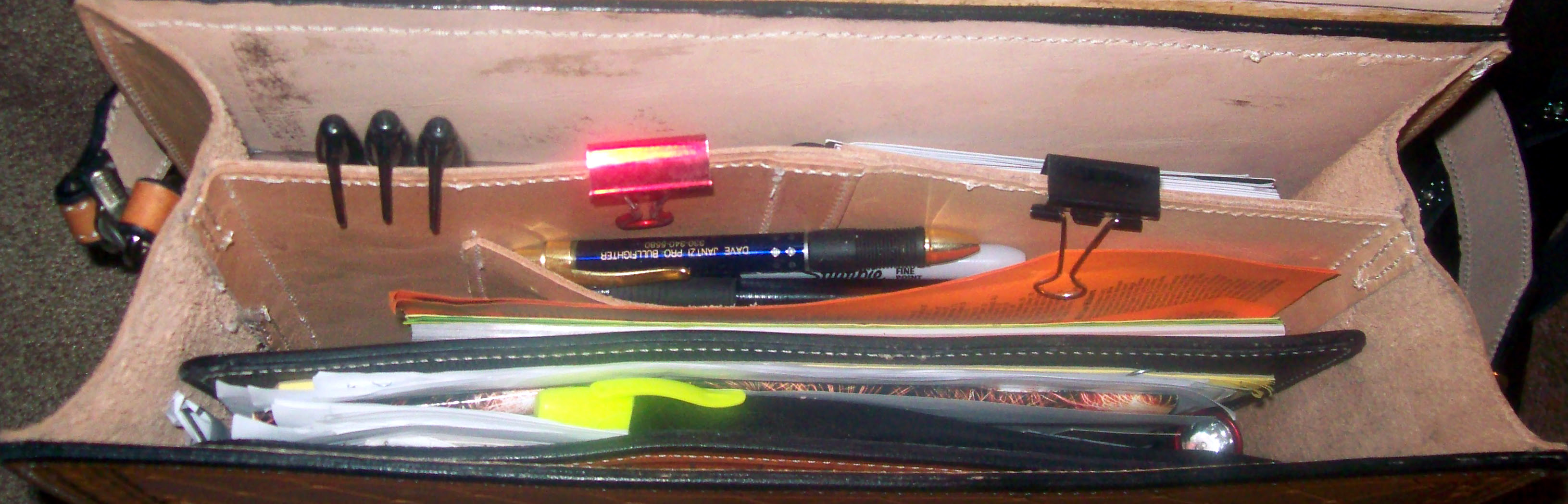

Members Double U Leather Posted July 15, 2009 Author Members Report Posted July 15, 2009 Thanks again everyone for all the positive comments. I really appreciate it. As for the insides, they're really pretty basic. It's simply a divider with a pocket for pens, etc., sewn to the gusset. Here was another construction issue I learned. At first, I cut the divider the same width as the case. Upon assembly, I realized the gusset would bow inward some, therefore the divider would be far too long. Of course, I had already sewn the divider to the gusset thinking once the gusset was sewn in place, the middle would already be done.....WRONG!! So, I unstitiched the divider, sewed the gusset in, and then had to hand stitch the shortened version of the divider. I'll try to get some pics of the insides up soon. LESSONS LEARNED: 1. Best case scenario, the front, bottom, back, and lid should all be one piece. If that isn't possible, back and flap definitely should be one piece. 2. Middle divider needs to be 1-2" less than the width of the case. 3. Complete all finish things, i.e. oil, neatsfoot, antique, tan kote prior to sewing in the lining. (I've got a few antique smudges where they don't belong) Manfrommuc......The pattern?! I used was just kinda looking at my old briefcase and duplicating the construction. (See Lesson 1). I think the guy who made my old one didn't have enough leather to do all of it in one piece, so he sewed the flap to the back. As for the tooling pattern, again, I just kinda winged it. I figured out where I wanted the tooling, drew the circles, and tried to fill the space. As Hidepounder pointed out, the leaves of the "whateverbacus" place were too wide. I needed to make my other leaves wider, and more of 'em. The grid work part was a combination of realizing I didn't want to tool that stinkin' many flowers, and the fact that I'd seen that somewhere else and thought I'd give it a shot. Oh....some of the front part got a double tooling. On the first front, I put a stem in going the wrong way and didn't realize it until I began cutting and ran into the spot where leaves and vines were going two different directions. So I just took that fouled up piece and went to playing. Anyway, if ya'll have any more questions, fire away. Quote

Members Double U Leather Posted July 16, 2009 Author Members Report Posted July 16, 2009 Here's a quick pic of the inside of the briefcase. As I said, it's pretty simple. Just a divider with a pouch for pens, etc. Quote
