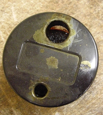

Members Mongo Posted January 14, 2010 Members Report Posted January 14, 2010 (edited) Hi Bob! I have added some of your ideas to my burnishing and edge fitting process after reading about your method on a different thread. I do have one problem that sometimes occurs. When I burnish before dyeing edges, sometimes some places on the edge don't want to take the dye. It doesn't matter if I use alcohol or oil base dye. Well known knife and leathersmith Chuck Burrows recommended cleaning the leather with alcohol right before dyeing and that does seem to help. Do you have any ideas on the topic? This problem is most troubling when I'm doing a black rig. I've attached a photo of edges on a recent project. Edited January 14, 2010 by Mongo
hidepounder Posted January 14, 2010 Author Report Posted January 14, 2010 Mongo, I experience what you are talking about from time to time, but I am ususally able to touch up those areas by reapplying the dye. I think what seems to make the biggest differrence for me is to let severything completely dry between steps (burnishing & dyeing). I don't like to wait after burnishing to dye the edges, I am usually dyeing right right away because I am impatient. However if I see that some aresas are not taking the dye I will stop and let everything dry before continuing to dye. I agree also, that sometimes utilizing alchohol will help. I edge sequentially this way because I have never been able to get a nice clean dye line by dyeing first. If I could I would dye and then burnish. I know this doesn't really answer your question. By the way, I think the edges you're getting on your holsters look good. Did you polish them with parafin when you were finished? That will really make them shine. Hope this helps... Bobby Does this work as well on thinner leather as it does on thicker pieces like belts? There comes a point at which leather is too thin to really tell it's been properly edged in my opinion, but I am curious as to what if any additional steps or products you would suggest for much thinner pieces. Some weights of leather are just too thin to burnish.....when they are I typically turn them back and sew them so that you get a nice finished edge. Hope this helps.... Bobby
