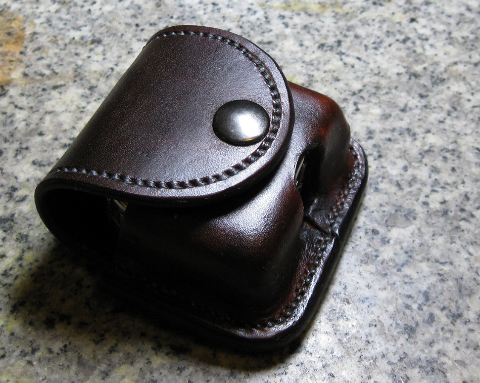

Hey Jim I use 6 cord pretty much 90% of the time and I use a 8 SPI for it. Looks really good IMHO. I dont think I would go any closer then that but thats just me.
This isnt the best sewing job around but it will give ya an idea of the combination of the 6 cord at 8 spi. Hope this helps.

MADMAXX22,
Very nice work!
Thanks for the input, I can see 6 SPI should be no problem. I will have to work my way up to 8 SPI though.
Jim
