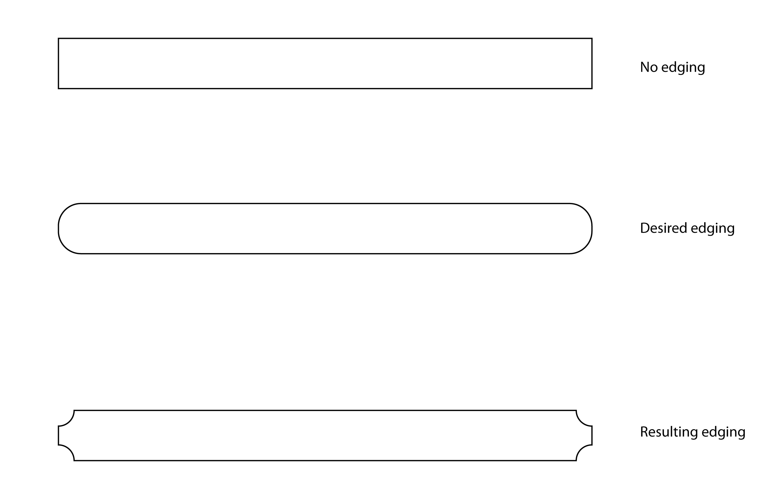

Members SimonJester753 Posted July 9, 2010 Members Report Posted July 9, 2010 I'm working on dog collars made from 8-10 oz latigo. I use a #4 edge beveler. See this illustration to get an idea of what's happening when I use the beveler: As far as I know I'm using the biggest beveler, yet it seems too small. Quote
Members D.A. Kabatoff Posted July 9, 2010 Members Report Posted July 9, 2010 If you are getting the type of edge in your profile, you may be using the wrong kind of edger (actually, I have never seen an edger capable of making that type of concave edge). On 8-10oz latigo I use either a #3 or #4 Bob Douglas common edger and get the rounded profile you are looking for. Perhaps you could post a photo of the edge of your tool so we can see why you are getting the undersired result. Darcy Quote

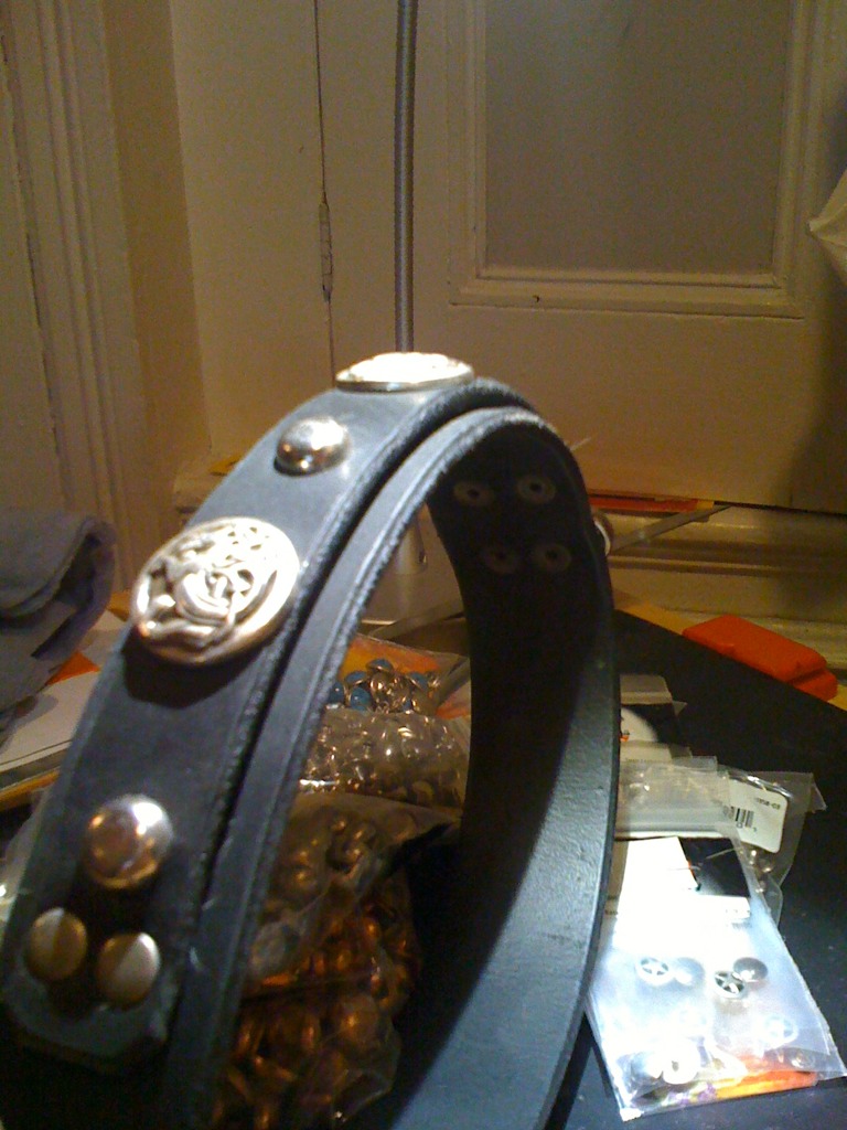

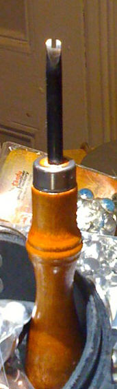

Members SimonJester753 Posted July 11, 2010 Author Members Report Posted July 11, 2010 If you are getting the type of edge in your profile, you may be using the wrong kind of edger (actually, I have never seen an edger capable of making that type of concave edge). On 8-10oz latigo I use either a #3 or #4 Bob Douglas common edger and get the rounded profile you are looking for. Perhaps you could post a photo of the edge of your tool so we can see why you are getting the undersired result. Darcy OK, here's a picture of the edge and of the edger. I got the edger from Tandy. I think it's a Craftool brand #4. By the way, my dog has been wearing the collar and been swimming in it a bit. Quote
Members D.A. Kabatoff Posted July 11, 2010 Members Report Posted July 11, 2010 Simon, I can't say for sure from the photos but from what I see it appears the edger may be too narrow for the thickness of leather and you may be trying to compensate and take off more edge than it's capable of. Are your pressing down quite firmly on the tool as you push it along? If you are, it may be pressing a crease into the top of the leather and still only taking a small amount of leather off the edge. If the tool is sharp, you need very little down-ward pressure on the tool as you push it along... the tool should only be removing material and not be leaving any kind of mark on the top of the leather. If you think what I've described may be happening, make sure the tool is very sharp and then try it on a piece of 4-5 oz leather and see what the edge looks like. The only other thing I can think of is the cutting edge looks fairly flat like a french edger instead of curved like a common western edger or a bissonette edger. Darcy Quote
