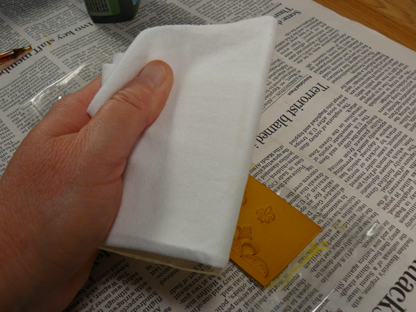

To apply the "top" coat of color, I often use a block of wood, MDF, or anything with a kind of a blocky shape that has a nice straight edge on at least one side. In this case, I found a piece of plexiglas I had laying around. (DO NOT use plexiglas with spirit-based dyes.) Then I take a soft cotton painters rag, or piece of old tee shirt, and wrap it snugly around the edge of the block I want to apply the dye with.
Notice here how I am holding the block applicator over the project as I am drizzling dye on it? Well, that's a very good example of what NOT to do! (Just wasn't really watching what I was doing, but fortunately, the drop that fell went onto the newspaper. - whew!) Anyway, just lightly soak the rag with dye. You don't want it to be totally saturated, but there needs to be enough to give you solid color.

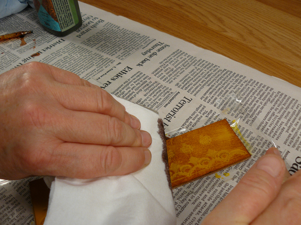

This was not a particularly good piece of leather, so I really had to work to get some color into it. But the idea is to wipe the edge of your block evenly over the surface of the leather, applying dye to the high parts, and leaving the impressions more or less untouched.
And here is the result. It looks a little grainy because of the poor quality of the leather, but this should give you a pretty good idea how the process works.
