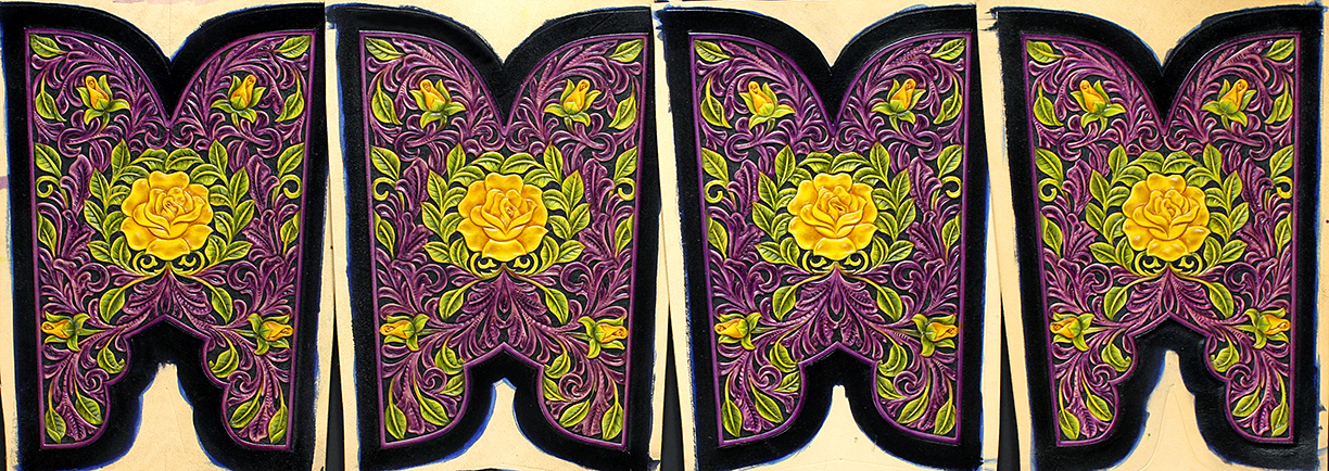

Here are some pictures of some boot tops that Peter Main has been carving, and one of the his belt from the Sheridan show. The boot tops were carved on 2-3 oz leather. The two small buds in the photo will be inlayed into each vamp. You will see the extension of the stems on the two front tops. All coloring is with spirit dyes.

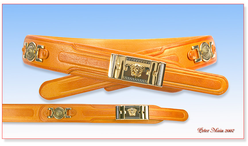

Info on the belt...
it is made from cowhide and fine goatskin. There are two layers of 2-3oz leather with a lighter weight for the plugs (these are the raised sections on both ends, and center back). All of this is bound in goatskin (including covered rivets), folding over all edges...the joins are barely visible as the goat has been skived to a feather edge. The overall coloring was dyed by spray, with the edges and raised sections colored by brush.

versace buckle ta'boot...nice!!

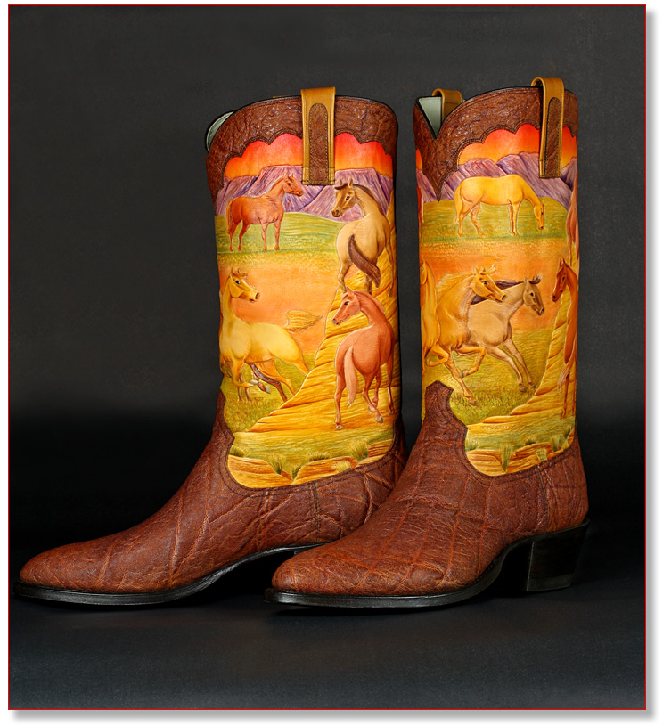

Marlon, I dont seem to have that picture, but if you have pictures, go ahead and add them here. Peter did say he would try and start posting his new pictures to the forum so everyone here can see them. Until then, I'll add a few more pictures that I have of some of his work.
attachment=11676:Boots_with_horses.jpg]Box_for_Shirley.jpg[at

It's almost impossible to wrap my mind around that kind of perfection. Clay, when you say "plugs" , are you referring to the inlaid pieces on the belt? If so, how are they attached or inlaid?
Ian, Plugs are scalloped under-layer(s) of leather that serve as a filler piece for applique embossed pieces. the plug is cut slightly smaller than the final size of the actual carved piece, and is scalloped to give the overall definition of the piece. Then a thin layer of leather is carved normally and is then molded on top of this plug and glued to it. this is how he gets the 3d effect on most of his work.

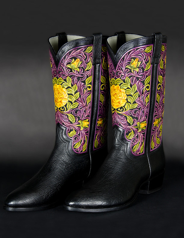

Here are a couple pictures of the finished boots Peter carved the tops for.
Comments from Peter
...I posted some boot tops some time ago...and now, here are the completed boots made by Wheeler Boot Company...Dave Wheeler is a master.
