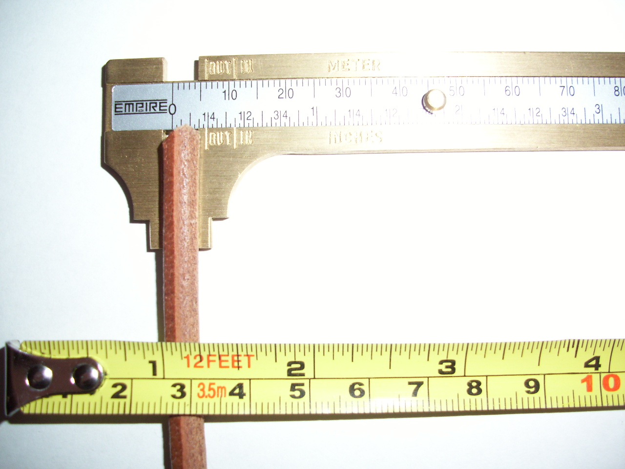

acox4t4 Posted May 14, 2011 Author Report Posted May 14, 2011 Ok a picture will hopefully clear things up. I'm using the belting, I took a string and put it around the belting to come up with 7/8 for the one and 1 inch for the other. Maybe I don't know how to read a tape measure or something but I thought that you took the whole way around and then divided by number of lace you want to use to come up with how wide the lace should be. LOL I just might need to get me one of those digital tape measure or something. Hahaha I even used tape measure with mm just for Bevan. Roo4u I crack myself up, I tried like 20 times to make one of those splitters from that post you sent me and I just don't have the wood tools to get a nice clean even cut at an angle. Since I need a splitter really bad I just need to take the pattern to a wood worker that has the right tools and have them do it. Its darn embarrasing hearing how easy it is to make, or seeing Knotheads easy splitter by using a piece of wood with a notch in it and just a blade and then seeing him split his roo so easy. I'll get there though, I'm not giving up. Watching Knotheads video and how he talks about blood sacrifice I'm kinda suprised I still have my fingers since so far I've been pretty bad at this hobbie. It's kinda like golf though, even when ya shank it in the woods its fun hitting the ball. Thanks for the help, you all are great. Quote
Members rawhide1 Posted May 14, 2011 Members Report Posted May 14, 2011 I must admit I thought wow those are some big reins. But each to their own. It turns out I thought ya were talking the diameter(across) of the core when ya were talking about the circumference(around) of it. Now it makes sense!! Ya dont have monster hands!! Looking forward to seeing the finished product. Mike Quote
Members roo4u Posted May 14, 2011 Members Report Posted May 14, 2011 whew....ya circumference.....ya had us all scared..lol you do measure around to get number of strands but core measurements are usually listed in diameter. well my lil splitter is not nice even or clean...its a wreck...but it works. i would love to buy a nice one but just too much money... Quote
Members KnotHead Posted May 14, 2011 Members Report Posted May 14, 2011 Ok a picture will hopefully clear things up. I'm using the belting, I took a string and put it around the belting to come up with 7/8 for the one and 1 inch for the other. Maybe I don't know how to read a tape measure or something but I thought that you took the whole way around and then divided by number of lace you want to use to come up with how wide the lace should be. LOL I just might need to get me one of those digital tape measure or something. Hahaha I even used tape measure with mm just for Bevan. Roo4u I crack myself up, I tried like 20 times to make one of those splitters from that post you sent me and I just don't have the wood tools to get a nice clean even cut at an angle. Since I need a splitter really bad I just need to take the pattern to a wood worker that has the right tools and have them do it. Its darn embarrasing hearing how easy it is to make, or seeing Knotheads easy splitter by using a piece of wood with a notch in it and just a blade and then seeing him split his roo so easy. I'll get there though, I'm not giving up. Watching Knotheads video and how he talks about blood sacrifice I'm kinda suprised I still have my fingers since so far I've been pretty bad at this hobbie. It's kinda like golf though, even when ya shank it in the woods its fun hitting the ball. Thanks for the help, you all are great. Trust me, I did not get there easily. It may look easy. But I have done a lot of practice and put some time into learning it. I do have this to say about the blood sacrifice. I don't care who you are in the braiding world. You will give up some of that precious blood at one time or another for this art and craft. Some where, at some time you will nick yourself, or cut yourself. This only happens when you're pushing yourself beyond the tired point though. That's the only times I have done that. It all comes down to paying attention real close to what your doing and how you have your benches setup. I admit that the piece of wood and a blade is kind of archaic to most. But it does work when you need to split and you're not in your shop with a good one. LOL... I wish you all the best in your journey with leather braiding and keep practicing. Because you can only get better at it. B... Quote

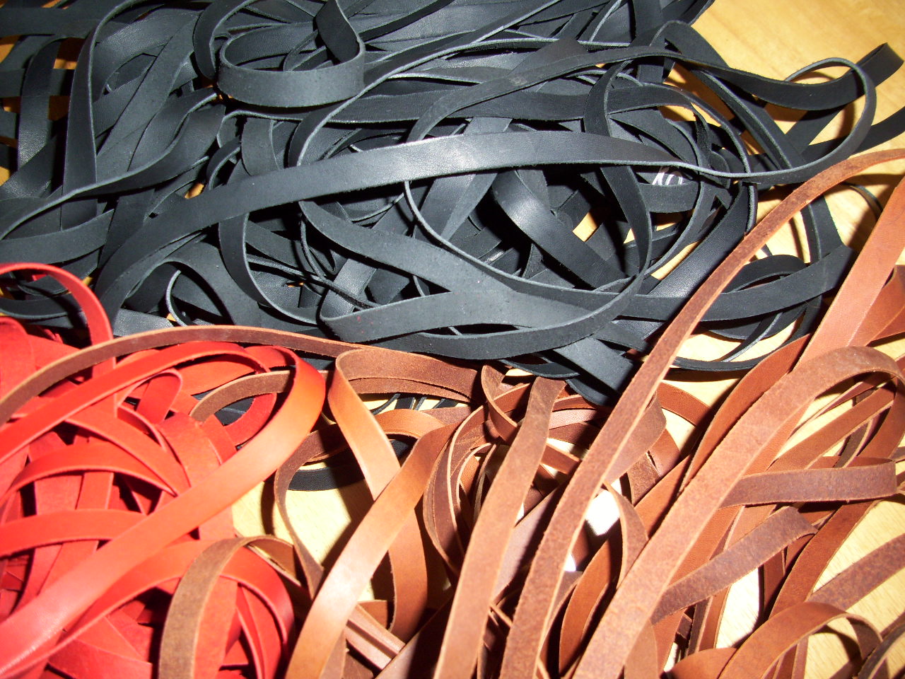

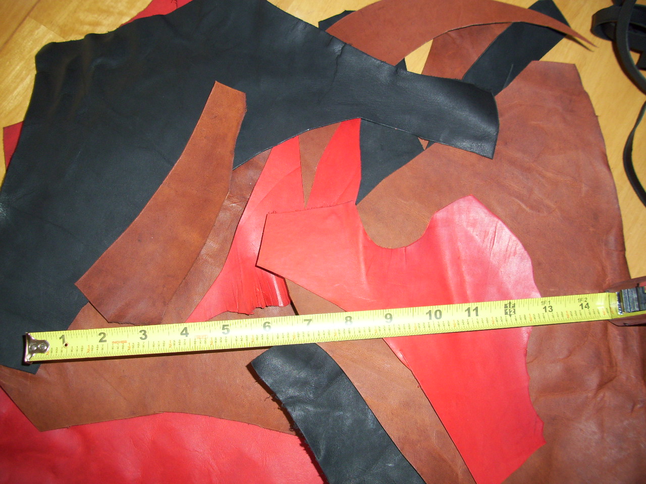

acox4t4 Posted May 16, 2011 Author Report Posted May 16, 2011 Well how is it looking so far?? First cut done on all 3 hides cut at 3/8 inch. Is those scrap pieces used for anything?? Do ya continue to cut lace all the way to the middle. As you can see I stopped once it was getting to be pretty tight, Will stretch then do the hard part. I'll try and take pic's of how I got the cutter and beveler set up so that if someone sees me doing it wrong will be able to give me some tips. Expecially with the bevel, for some reason the lace wants to fold up even with me pushing down on it to try and keep it from folding up. But maybe with me starting out with wider lace that might help. We will see. Just wanted to post pic's of what I have so far to show how the process is going. Thanks Annette Quote
Members KnotHead Posted May 16, 2011 Members Report Posted May 16, 2011 Well so far, all appears to be going just as it should with the rough cutting. B... Quote
Members roo4u Posted May 17, 2011 Members Report Posted May 17, 2011 you can get a bunch more smaller lace outta those pieces....looks pretty good...i think you have been psyching yourself out...and just needed to get started! Quote
Members Bevan Posted May 17, 2011 Members Report Posted May 17, 2011 (edited) Well how is it looking so far?? First cut done on all 3 hides cut at 3/8 inch. Is those scrap pieces used for anything?? Do ya continue to cut lace all the way to the middle. As you can see I stopped once it was getting to be pretty tight, Will stretch then do the hard part. I'll try and take pic's of how I got the cutter and beveler set up so that if someone sees me doing it wrong will be able to give me some tips. Expecially with the bevel, for some reason the lace wants to fold up even with me pushing down on it to try and keep it from folding up. But maybe with me starting out with wider lace that might help. We will see. Just wanted to post pic's of what I have so far to show how the process is going. Annette Gday Annette I have taken 5minutes or so of video tonight about setting the beveler up for beveling and will try and post it on youtube tomorrow night , if all goes well I will sent you and Joe a link When I rough cut my lace I normally end up with a piece about the size of a bike seat left over , when the turns get a bit tight , i just cut the tight curve out to make it abit smoother to go around , then with the bike seat size left over I use a Tandy lacemaker and get a heap more lace that has very littlle stretch in it because it is in the middle of the roos back Sorry you are having a hard time with the beveling side of the cutter , hopefully this video will help you sort it out Cheers Bevan www.wbrwhips.com Edited May 17, 2011 by Bevan Quote
Members KnotHead Posted May 17, 2011 Members Report Posted May 17, 2011 Bevan. I do the same thing as you do with my left over piece. I thought at one time that it would a crazy thing to do. But seeing you do the same thing with yours, I am now a bit more relaxed about it. Thanks for that post. B... Quote

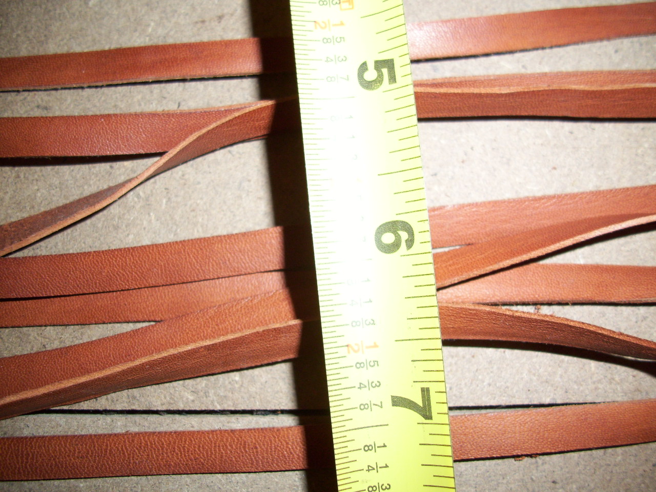

acox4t4 Posted May 18, 2011 Author Report Posted May 18, 2011 (edited) Here are some more pictures of the next step that I took. I made a straight cut, trying to cut off the wavey and taking the lace down to 1/4 inch. So I guess I'm ready to bevel? My hands begin to shake at the thought of it. Is all still looking ok at this point? Bevan does it look like I'm setting up the tool right for the straight cut?? For some reason the side rolls up on me sometimes causing some spots to not look good and straight but hopefully if I can figure out how to bevel correctly then those spots I'm sure will be cut off (hopefully). I'm down to 1/4 inch wide, my goal is atleast 1/8 inch wide when all said and done. Bevan thanks for taking the time to video tape for us. Greatly appriciated !!! Edited May 18, 2011 by acox4t4 Quote
acox4t4 Posted May 18, 2011 Author Report Posted May 18, 2011 Here are some more pictures of the next step that I took. I made a straight cut, trying to cut off the wavey and taking the lace down to 1/4 inch. So I guess I'm ready to bevel? My hands begin to shake at the thought of it. Is all still looking ok at this point? Bevan does it look like I'm setting up the tool right for the straight cut?? For some reason the side rolls up on me sometimes causing some spots to not look good and straight but hopefully if I can figure out how to bevel correctly then those spots I'm sure will be cut off (hopefully). I'm down to 1/4 inch wide, my goal is atleast 1/8 inch wide when all said and done. Bevan thanks for taking the time to video tape for us. Greatly appriciated !!! Quote

Members Bevan Posted May 18, 2011 Members Report Posted May 18, 2011 Here are some more pictures of the next step that I took. I made a straight cut, trying to cut off the wavey and taking the lace down to 1/4 inch. So I guess I'm ready to bevel? My hands begin to shake at the thought of it. Is all still looking ok at this point? Bevan does it look like I'm setting up the tool right for the straight cut?? For some reason the side rolls up on me sometimes causing some spots to not look good and straight but hopefully if I can figure out how to bevel correctly then those spots I'm sure will be cut off (hopefully). I'm down to 1/4 inch wide, my goal is atleast 1/8 inch wide when all said and done. Bevan thanks for taking the time to video tape for us. Greatly appriciated !!! Gday mate your set up and technnique for the lace resizeing looks good Your fence on the bevelling set up looks way to high , have a look at this link I hope this will clear a few things up for you , Cheers Bevan www.bwrwhips.com Quote
