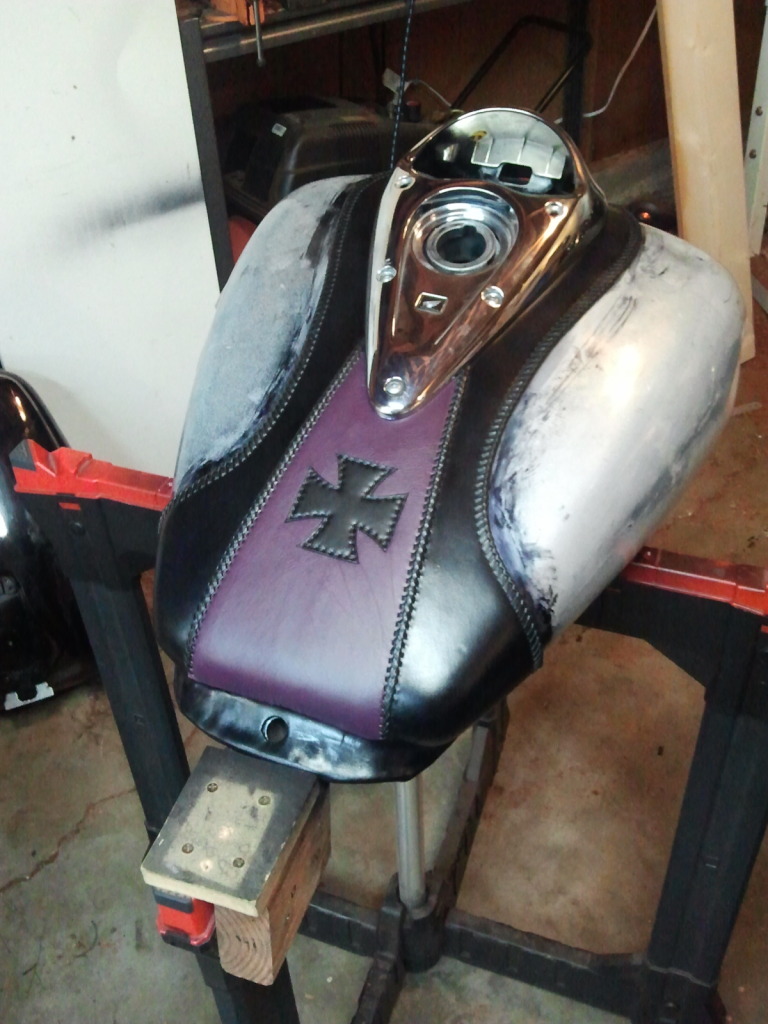

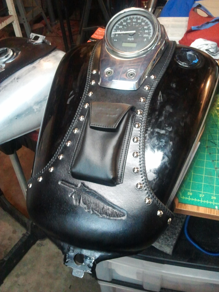

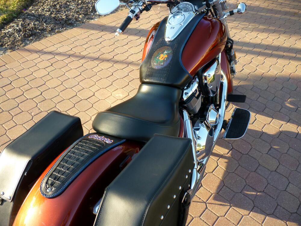

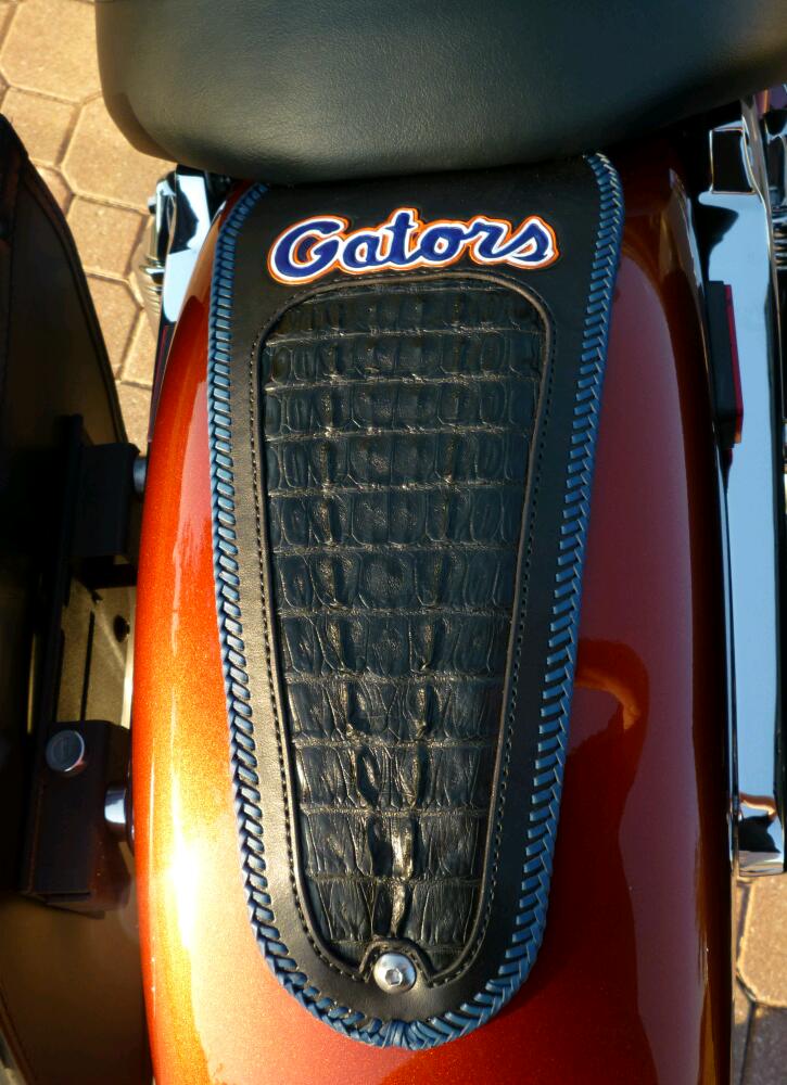

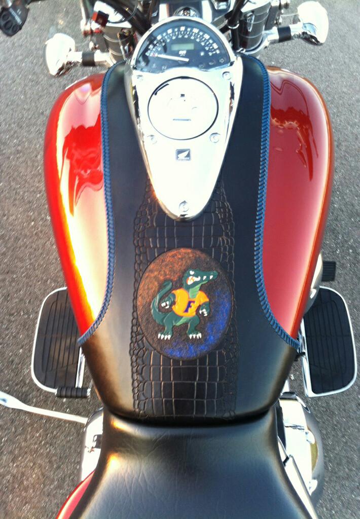

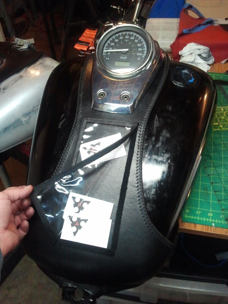

Members Spinner Posted December 28, 2011 Members Report Posted December 28, 2011 I haven't posted many pics lately as it was a mad rush just to keep up with orders. Here are a couple of new ones I did as the result of Christmas orders, haven't gotten pics of them on the bikes back yet as folks are still getting back to their homes & bikes so shop pics will have to do for most of them. The first one is a Florida Gators themed tank & fender bib set I did. Starting with the tank bib, it’s Hermann Oak 5/6 oz veg tan leather with a custom “fierce Albert” relief tooled into the center, surrounded by a tooled Gator belly pattern. An inlay wouldn’t have worked but we wanted to continue the theme of the gator hide throughout so I tooled it in instead. Royal Blue kangaroo lace in a triple loop pattern for the edges round it out. The color is done using Golden Fluid Acrylic paints. For the fender bib, we started out simply looking at the “Gators” lettering and again one conversation led to another which led me to looking at alligator hide prices. The inlay is real alligator tail (had to use the tail for the back of the bike!) inlayed into the same 5/6 oz. Hermann Oak leather and lacing & paint as the tank bib. This one was even more challenging as I didn’t have the pattern for the 1800N yet so Jim and I coordinated measurements & photos via email, decided on a shape (pennant style) and then the client crossed his fingers and hoped I’d get it right. I think it worked out pretty well… Next up is a bib a client ordered for her husband to memorialize his brother who died of cancer earlier this year. Celtic triad cross in Ultramarine blue with the memorial text below. There was so much text in such a small space that I decided to literally carve it in with my TurboCarver II and the bone cutter bit instead of tooling it. It worked out pretty well, a very slight fuzz on the edges and the flesh was a bit soft underneath. Using my finger to remove the fuzz and lightly burnish around the lettering and then I used a small modeling tool to press/dig out the soft flesh and then dyed the piece. Once dyed, I sprayed on the top coat and used a small pointed brush to saturate the inside of the letters to stiff the flesh inside so it wouldn't fuzz up or come loose. Made for a great flat contrast against the satin bib. Following that was a set of bibs and lever wraps for a couple with similar bikes. The first one (hers) has a tooled feather and cell phone pocket. The second one (his) has a 4.5" x 10" vinyl map pocket. The vinyl is edged with black chrome tan and the bottom and right sides have velcro to allow easy opening of the pocket to insert maps, cards, etc. The chrome tan edging and velcro attachment give the pocket just enough lift to make is easy to get a semi-thick map in there without having to 'squeeze' it in. The lever wraps are map out of the same 2 oz. black chrome tan. I deviated from the normal design of eyelets & lacing and instead skived & doubled the chrome tan and then punched the holes to work the same as a shoe laces up and then used 5 cord waxed hand stitching thread. The client simply slips them over (I prestitched them over a 1/2" dowel) and tightens the stitching so it lays nice & tight similar to how a wrapped steering wheel looks & feels. Last but certainly not least was a two-tone bib that a client requested. He had procured the plum purple chrome tan from a local large name brand shoe factory and it matched the accents on his bike "Purple Haze" pretty well. I tried a couple of variations of how to make it work but in the end we were both happiest with this result. The bib was formed, dyed & finished as normal and then the purple chrome tan cut & glued on top of it. To highlight the color change and hide the join of the two pieces I did a line of applique braiding down both sides, reversing the run down the right side so they both 'run' in the same direction. Then a black chrome tan maltese cross was glued & stitched over the top of the purple to finish it off. Enjoy! Chris Quote
Members Rohn Posted December 28, 2011 Members Report Posted December 28, 2011 Really cool. I like the feather and the cross the best, but all are great. Quote
