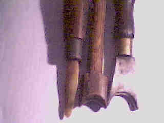

swivelsphinx Report post Posted July 8, 2008 I find that having a variety of burnishing tools is helpful. I have used actual bone folders (I make them out of cattle and deer bone), antler burnishers, nylon "slickers", and folded pieces of light canvas. It helps to use an edger first, and moistening the entire edge slightly doesn't hurt either. I like gum tracaganth on by belt edges and portruding bag seams too! Did you learn that one from Mike Button?I wonder if an amber furniture wax or bowling alley wax might not give similar results... hmmm.... Quote Share this post Link to post Share on other sites
