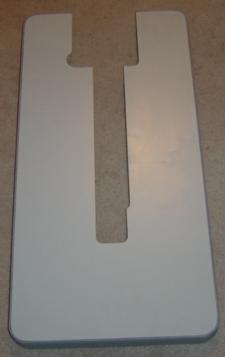

The 4500 doesn't come with illustrated parts or assembly instructions and I have a few pieces that I'm not sure what they are or where they belong.
There is what I think is an optional table but I don't know where it goes or what it's for.

The top one is a table of sorts. It sides on your arm. I'm not sure how fastens. The second one is a wax pot it fits on the top of machine in front of the top thread guide. You should see a couple of bolt holes. You put thread lube in it and run your sewing thread through it.

Your table does not need to be put on. Actually I took mine off and it works better.

The table top attachment has four screw holes on the bottom right side. You should have received a package with four 6" long threaded rods, 8 nuts and washers and four plastic hand screw caps. Install a threaded rod into each screw hole in the wood. Then install a washer and nut and tighten them against the wood. Install another nut on the other end of each rod, about 2 inches up. When you are ready to use the table, slide it over the cylinder arm until the cutout reaches the inside right of the body. Slip a washer onto the ends of the rods, then push down the attachment so that the four threaded rods go through four holes in the pedestal table. Use the plastic thumbscrews to secure the table top to the pedestal.

You MIGHT have to make a small notch on the bottom of the table to go around the thumb screw that holds a cover on the lower front of the machine. I had to, but maybe the person doing the router work just sneezed when they were doing mine. It would not go on otherwise.

Are you using the flatbed table and if so, for what purpose?
The one that was shipped to me is missing a threaded insert, it only came with three instead of four.

Yes there is a definite advantage to having the table. While I haven't used mine much I would be looking at making one if I didn't have it. My wife used it when she sewed my elk hide vest. You will find it very handy if you sew pieces more than 4 inchs wide or soft things, it keeps them from hanging of the end and tending to pull the work so you get crooked stitch lines.
Phone Bob he will surely send you the other bolt.
