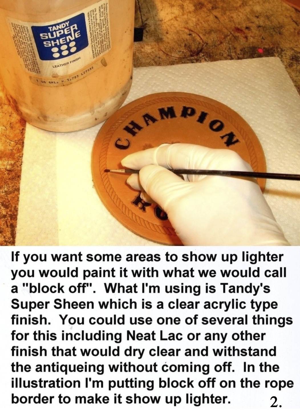

Members radar67 Posted March 2, 2012 Members Report Posted March 2, 2012 (edited) Iron Pounder, it sounds like the product may be going on too thick. I tried resolene straight from the bottle and it appeared thick to me. I started mixing with water and use the cheap bristle brush Dwight mentioned on most of my projects. I have airbrushed the resolene on and got good results. I had a leather arm bracer autographed by a band I like and sprayed over the Sharpie signatures to protect them. Hectron, I started out with Satin Sheen and was very disappointed with it when I tried to use it as a block for antiquing. The project came out okay, but much darker than I had planned. As was stated earlier, I think the "Sheen" products are good "starters". However, there are many other finishing products on the market that are much better. Resolene is the product I am comfortable using and it does what I want it to do for end results i am trying for. There are many people who bad mouth do not recommend the ECO Flo products. I use the dyes, highlighters, cova colors, and antiques and am pleased with them. I have used the "all in one" while helping a friend with a class and was not impressed with them, neither was my friend, a 17 year leather veteran. I think experimenting with the different products to find what fits your needs is the best practice. I still have a few products I want to try eventually, but for now the resolene and Eco Flo dyes work for me. A thought on the "plastic" look. I think I may try the resolene mixed 25/75 with water to see if I can produce a satin finish with resolene. Edited March 2, 2012 by radar67 Quote
